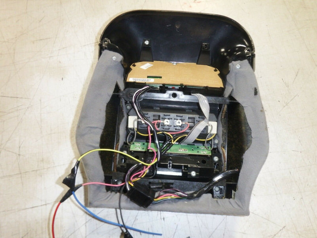

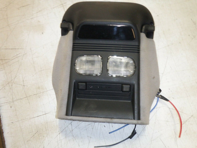

Here is the console. Any advice is greatly appreciasted!

What year is the salvaged console from? I have done quite a bit of work on the older versions and they definitely don't need anything from the computer. The Outside temp info comes from 2 wires connected from the console directly to the display board and the compass reading is generated directly from the board. I have fixed a ton of the old style that had the set buttons on the display board and probably about a half a dozen of systems that look similar to yours and have the buttons located at a different point in the console. If the display board in yours is similar to one of those it should be possible. Any chance you can take a closer pic of the connector on the display board? As I look at this pic, I don't see it. The Display board would normally sit behind that dark tinted window. The backside picture looks like it is missing. Do you have that part pulled out already?
I don't know what year the console is from. I do know that they were all the same form 97-2001 (which this is from that range). The only difference is the vehicle end of the wiring harness that plugs in to the passenger footwell. 97, 98, and 99 each have unique connectors, and 2000-2001 are the same.
The display board is there. It's under the tan-colored plate at the top. there is a gray ribbon connector that connects it to the 2 buttons, which are part of the green PCB down in the lower half. The black square connector is what interfaces with the vehicle to supply that data.
