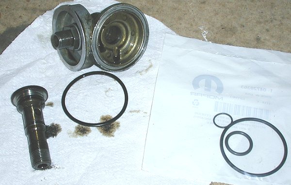

Hi y'all - I just got my first Jeep (2000 Cherokee Sport XJ w 4.0l, automatic) yesterday and will be changing the oil & filter this week. I'm a little confused about the 'oil filter adapter o-rings' talk. I've never had a car that required any kind of adapter for an oil filter.
I hope you don't mind me piggy-backing on the topic for that question, I see you have your resolution and I'd feel bad creating a topic for something so (probably) obvious to a non-newbie.
You only replace the seals if they are leaking, not with each oil change. Use a quality oil filter like Wix or Napa. Stay away from Fram, sTP etc.
The oil filter adapter It is the part mounted to the engine that the oil filter screws onto, most were put on too tight @ the factory eventually causing the seal to leak oil.
Here is a photo of the adapter off the Jeep
