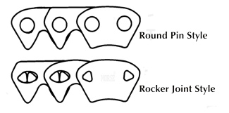

I might of missed it reading through this, but what's the difference between the European(police package) and standard chain?
Round Pin vs. Rocker Joint. The Round Pin is what is found in most 242s. The Rocker Joint was used in the Police Package and Export 242's as well as the Civilian H1 242. Supposedly the Rocker Joint is more efficient. These chains have been discontinued for some time and are extremely difficult to find, you can use a Round Pin Chain in its place.
