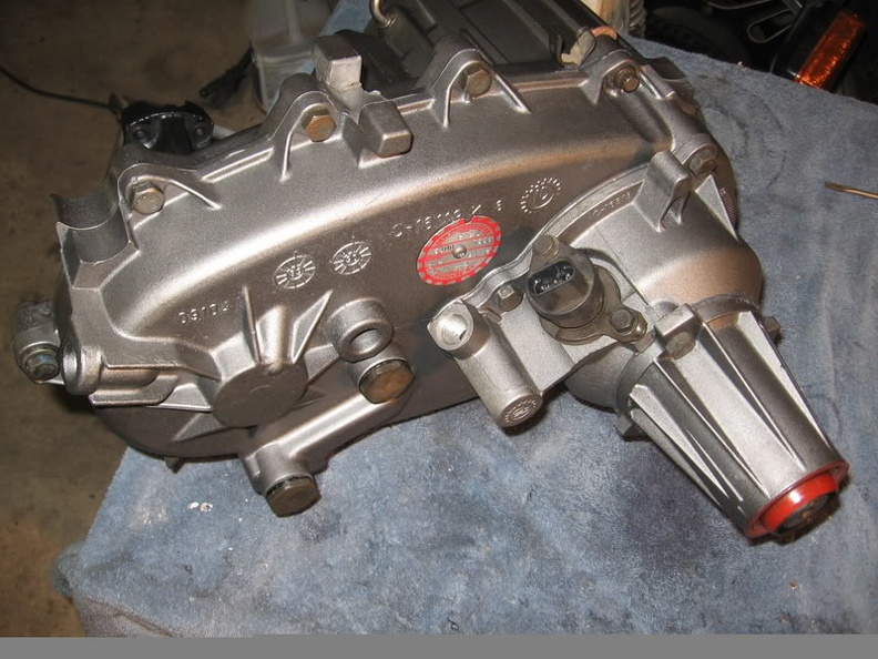

And for visual sake, here is a side by side of a 242 compared to a 231. I was skeptical that the 242 was THAT much bigger until I saw them side by side
