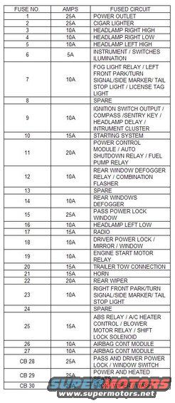

Engine Bay Fuse Box (PDC)
Kick Panel Fusebox
Can someone comment on this updated checklist?
