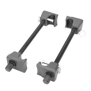

Spring compressors are free to rent from autozone /advance auto. You buy them and then return them for 100% refund. you want the strut style spring compressors ($50 @ autozone or advance).
I would have them on hand if I were you to make sure you dont get stuck on the install. I know my RE 6.5's just barely squeeze in with aftermarket LCA's and drop brackets.
