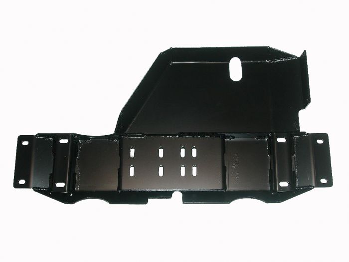

It's re-branded by Rugged Ridge and a couple other companies. I am curious what the overall quality is, though.

Just an update on the Omix-Ada/Rugged Ridge crossmember...
It fits, but barely. It has the slotted holes on one side of the crossmember (opposite side of the OEM one, which threw me off), and a friend had to hook some straps to it and pull it to one side to get the other bolts to thread.
I also had to bore out the transmission mount holes a tiny bit, likely due to the fact that the studs on the Crown mount I bought flared out a bit.
Otherwise, it's stout as hell and will be a great foundation for a transfer case skid hoop.
My plan is to just order some armor to fit over it all, instead of replacing the whole shebang.
My challenge is finding something a bid wider to fit over my frame rail stiffeners.

The JCR skid can be made to fit with stiffeners as well if I am not mistaken. I have that one and have balanced the whole jeep on it at on point or another.

this was built with just a grinder and a welder, and a dodge 3500 as a brake to make the bend (put a block under the plate and drove over it. worked like a charm), which turned out to be somewhat unnecessary, but made it hug a little tighter.
I could have easily made it to fit over stiffeners but didn't have them at the time. been on there for almost 4 years without an issue..
the crossmember is just some 3/16" C-Channel that I notched to clear the driveshaft and exhaust hangar.
