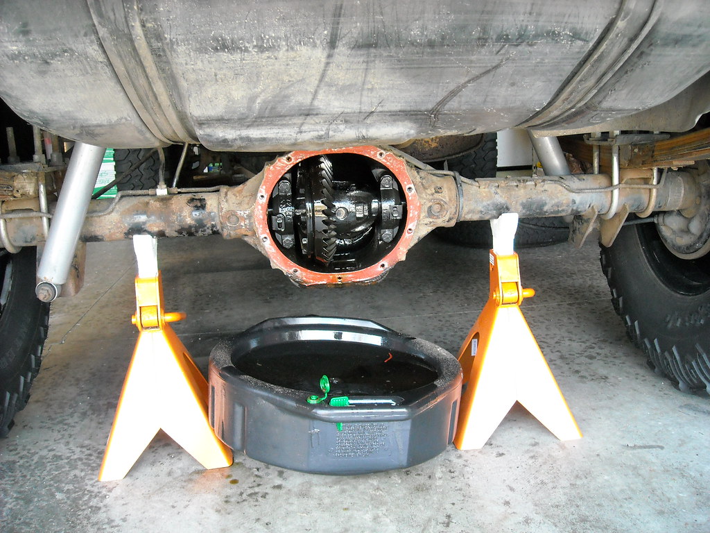

ok in right in the middle of the install, everythings out and now im putting it all back together. Thrust washers are out and on the right ends etc etc...need to know a couple things:
Can the c clips go in incorrectly (they are scored differently on each side) and im sure I will have a question about the locker...the pictures make zero sense...and ive done this twice on front diffs :)
You guys were right on with the c clips...just wiggle the axle when they are facing down until ya hear em go "cling"
Also...the spacers face open end in, correct? so they sit in the groove in the axle gear? the instructions dont make any sense when it comes to the direction you place them.
I got em in just fine. Thankya!
Now if I had the bolts for my ruffstuff diff cover I could button this thing up and drive it (They worked there way outta the box in transit, damn!)
Ill post some pics once everythings done to clear some things up for people in the future.

C Clips
Before
After
Fun with springs...use a big screwdriver to get them started, and then a smaller one to pop them over the "nipple" - I used vaseline to hold everything together, works as well as axle grease when you forget to buy axle grease :)
