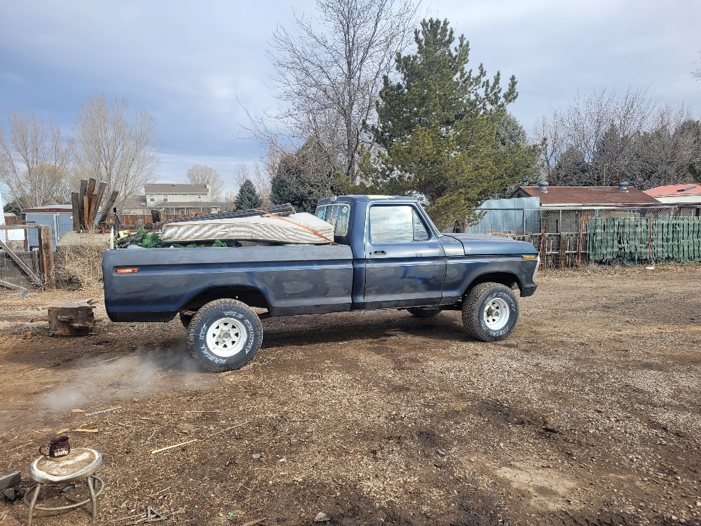

The 76 is drivable finally.
Survived a dump run actually runs pretty good lots more get and go than the jeep 4.0

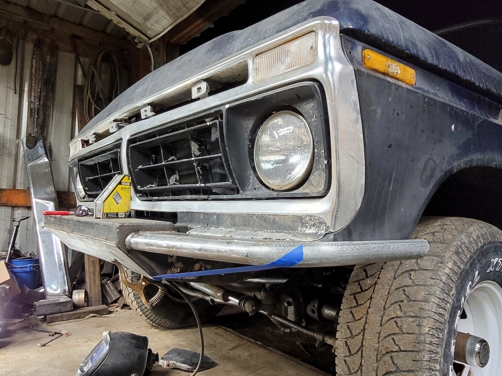

Working on bumper. Yes I cut the lower fenders off.
Have a few more bars to toss on and tie wrap around to frame. I love saying frame.

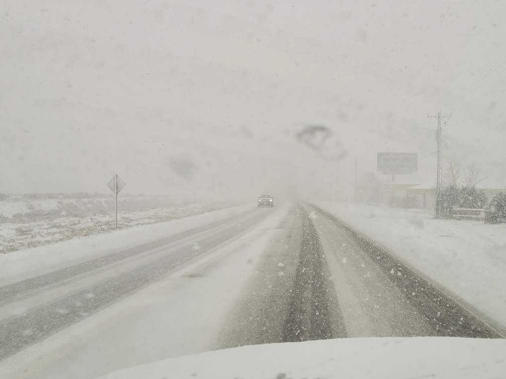

Is it snowing over there? Working in mtn home and its snowing like 6" an hour or is that 6 flakes an hour.
What have you been up to?
I have been getting the 6 flakes an hour stuff...step out of the shop and it is sunny. Step out 10 minutes later and random white flakes are on my saw. It has started to come down a bit more aggressively now that I have stopped for lunch.

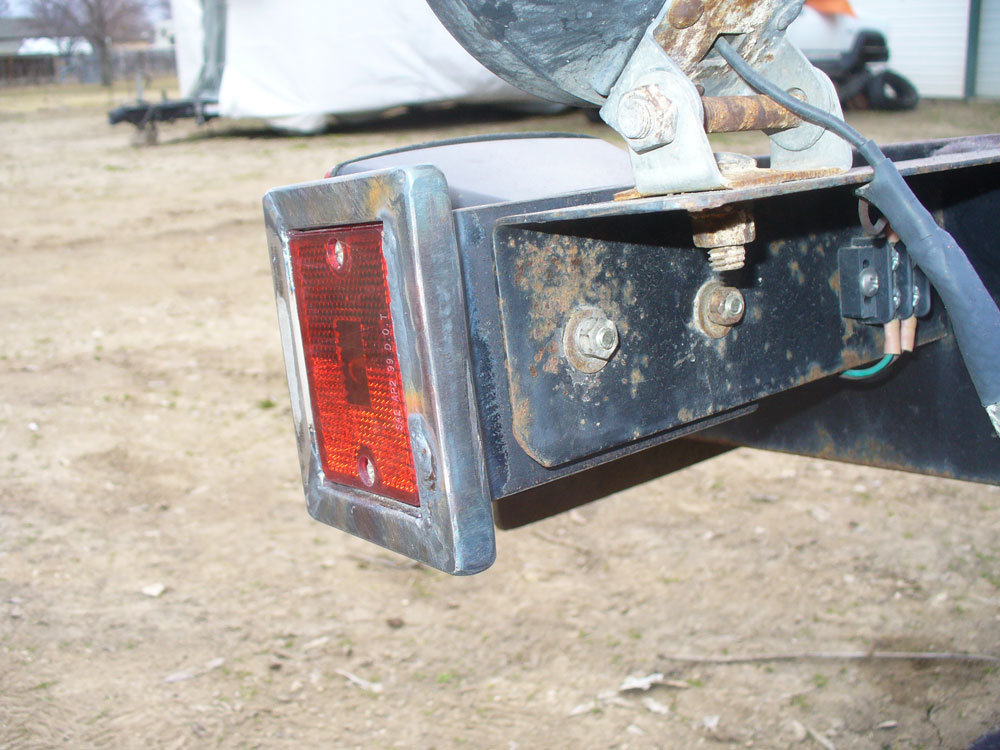

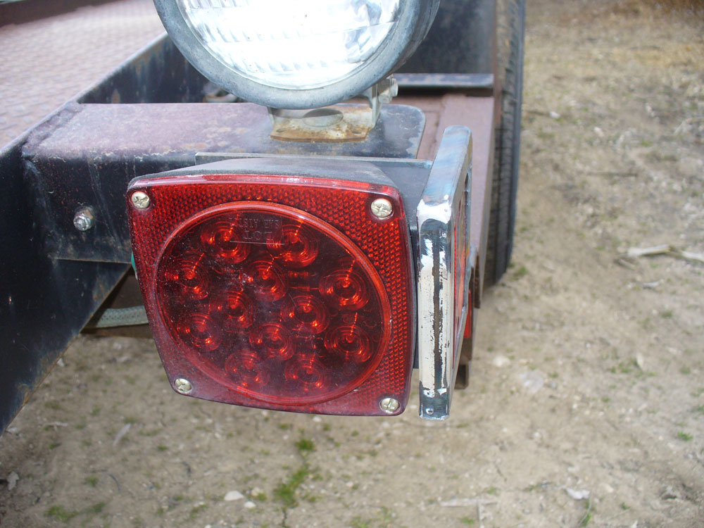

At the moment I am trying to fabricobble some protection for the tail lights on my car trailer. Need to go pick up my '95 XJ, and I have no doubt the lights won't survive another trip through the brush.
Yes aggressive snow now.

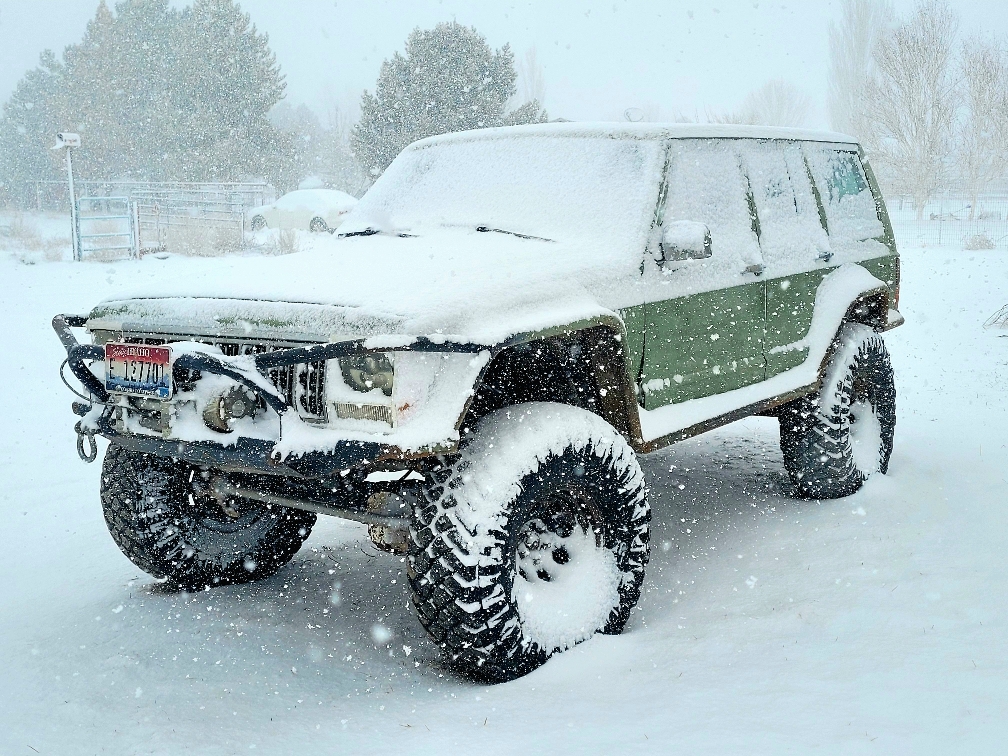

Ford poser shot with its semi unfinished bumper. Bumper Center is 1/4" and boxed to stiffin around winch bolt pattern. Need to bolt winch on then figure out what I want for revovery points(cheap ones)
This project has sucked up more money than I had planned to get to this drivable stage.
Probly going to try foa shocks 12 or 14" and maybe 1-3" coils to lift front alittle then fab shackle reversal to lift rear 1" ish to level with front maybe 1" higher.
It has a broken ujoint in the front or some kinda limited slip thing. I might put a spool in it if theyre available for the 44 or weld the spiders to case.
Cant forget castor bushing is shot. I haven't measured but it looks and drives like it doesnt have any positive castor.
I think ive decided not to do 3 link for now. . The front shocks I might do threaded bodies for that rainy day that I might happen to have parts for a suspension build. Luckily its nearly identical weight compared to my xj . Kinda have dual rate spring rates figured out in my head.
Before that refresh all ujoints axles and drivelines and drive it ohhh and steering ughhh money.
This 300 with ported head and chevy stuff is a tourqe Monster. The carb is a 600cfm holley street avenger that I putt the truck avenger stuff in . Did a steep climb in 4low with no issues.
But ohhh man the xj rides offroad 200% better. This things for sure a old 76 ford truck.
