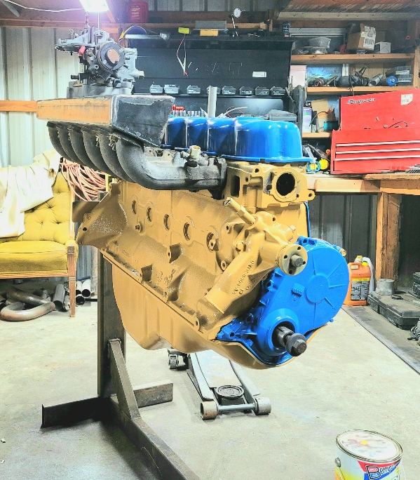

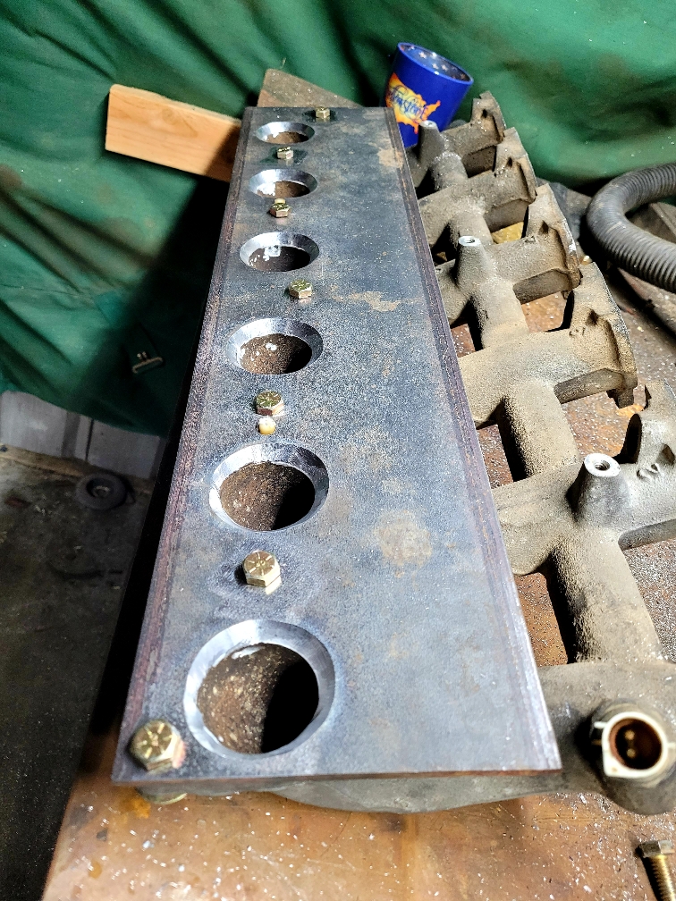

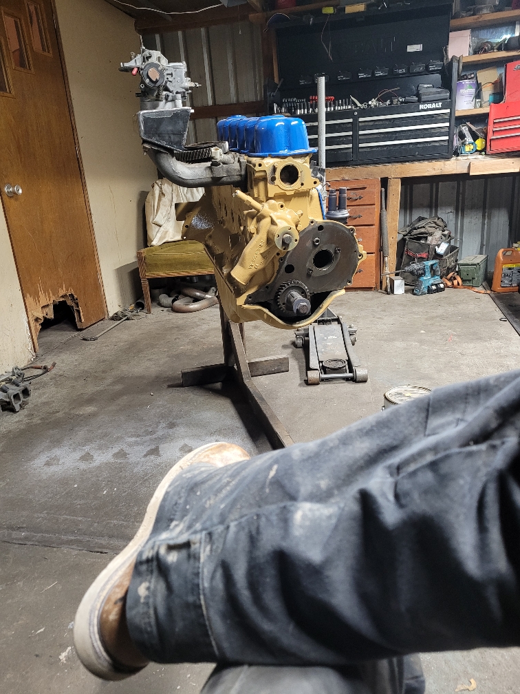

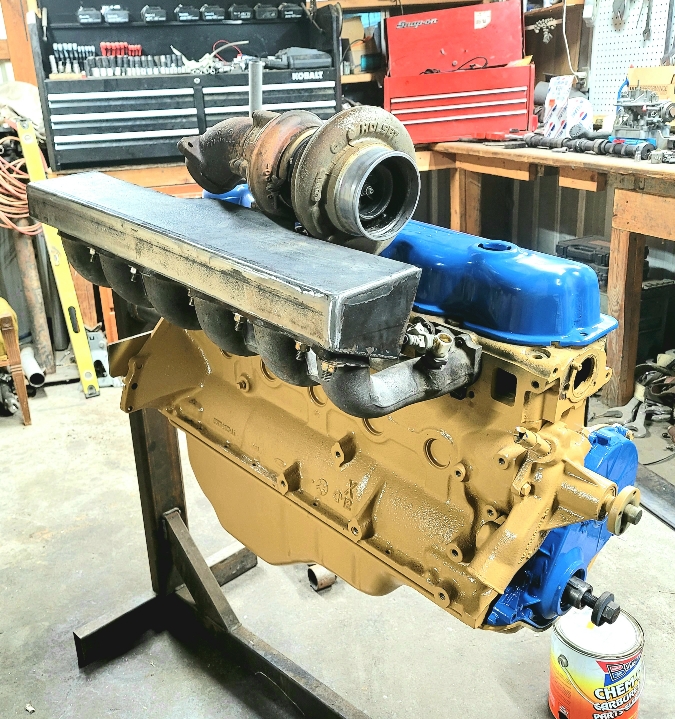

No jeep stuff lately have the ford 300 mostly together, I spent about 20hours researching how to port the head then about 40hours actually grinding it.
Now the heads at the machinists getting chevy 1.94/1.60 valves
Lots of research into this thing im building it for bottom end. Ive fabbed an intake Plenum hopefully the ford 300 guys steerd me right. Plenum is sized to promote low end power and intake velocity.
For some reason ive had a hell od time getting parts like cam, chevy valves, chevy rockers, chevy hei Distributor. I swear its a ford build.

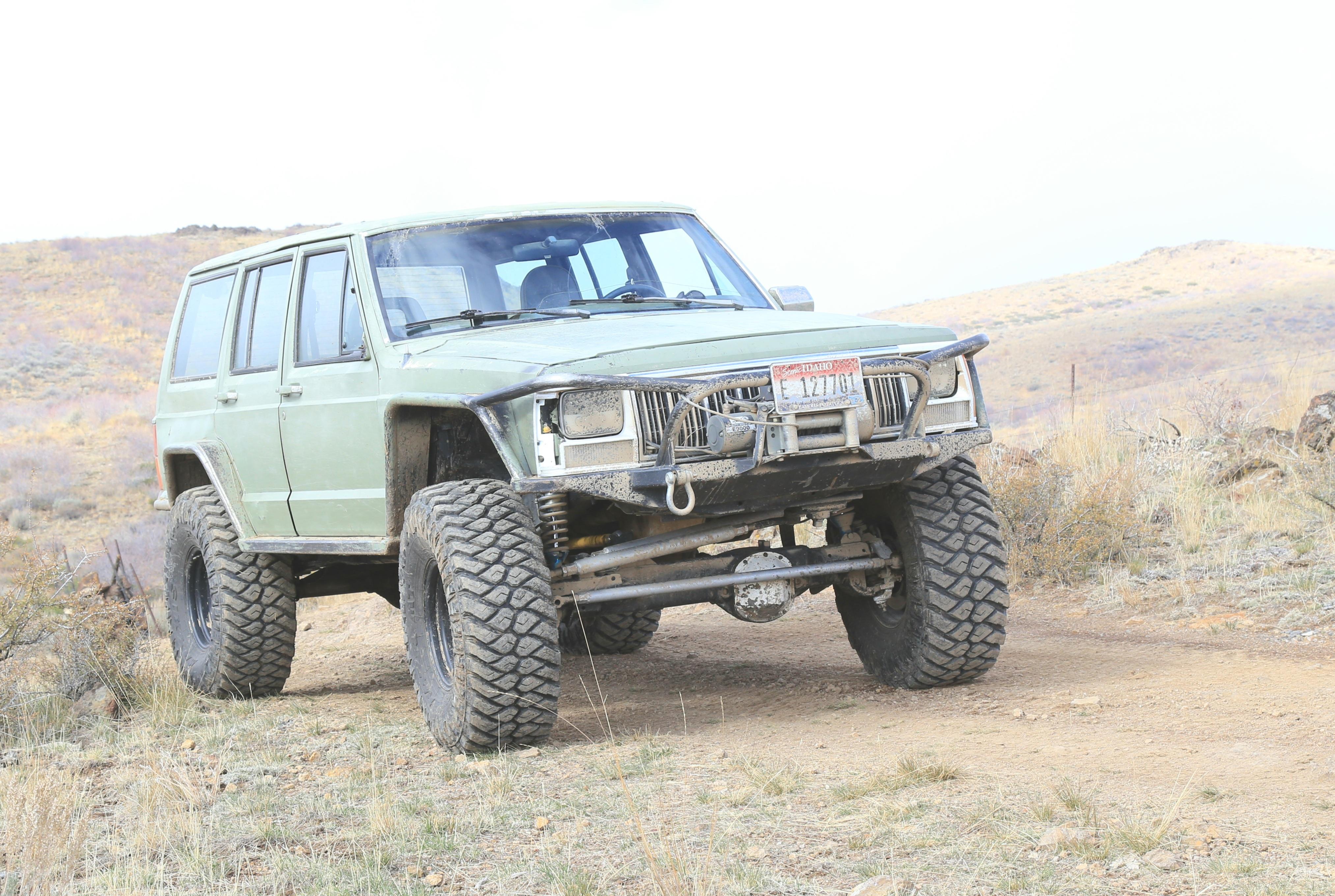

Building this has got me to wondering. Why couldn't these ford 300s be shoe horned into a jeep? Ofcourse they can
