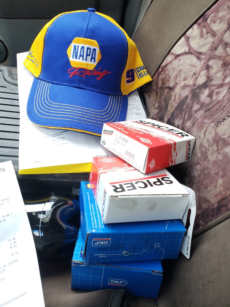

Joint upgrade day.

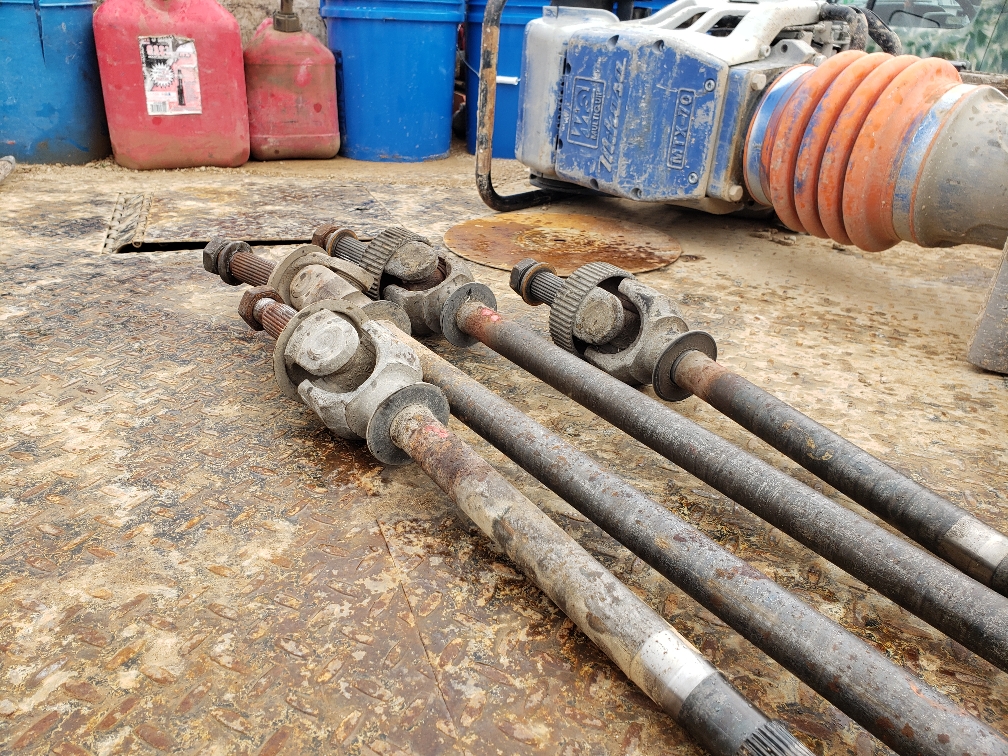

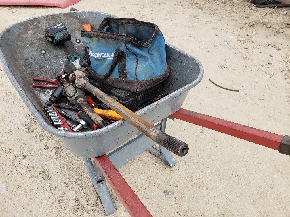

Pulled every shaft i could find even one with a bent inner due to a crash and a set from a 96 grand.
Then tracked down joints.
Now to work for a few hours. Then get shafts in tonight. Will remove tone rings and run spicers and have the skf for spares.
Hoping to hit the trail tomorrow on broke in gears but it didn't happen will have about 100 miles on rear gears going into carnage canyon.

Sounds like you got the shaft Lol
Did you check to see what size axles you bought?
5-760 size
Or are they 1310
A 93 xj had 260 joints to. All but one grand cherokee had cv's. I was after the big shaft.
Also went as far to test fit the grand shaft with tone ring on a xj.
Have alot of jointing when I get home
Front shafts survived a relaxing day.
Did do a trail working all fours snow mud running water clawing over rocks and through creeks had to turn around at a 5ft snow drift.
Fun stuff, the bigger shafts give alittle peice of mind though I know theyl still break. Have a the spares ready to go.

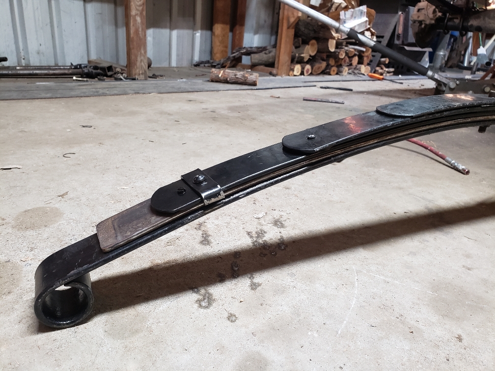

Crown 7" free arch springs
I may basted pack them though they look to have some arch left and have about 1" more shock shaft showing now.

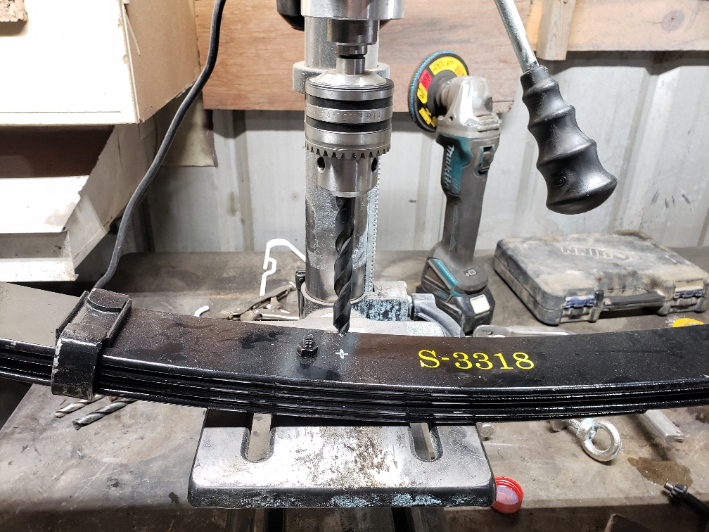

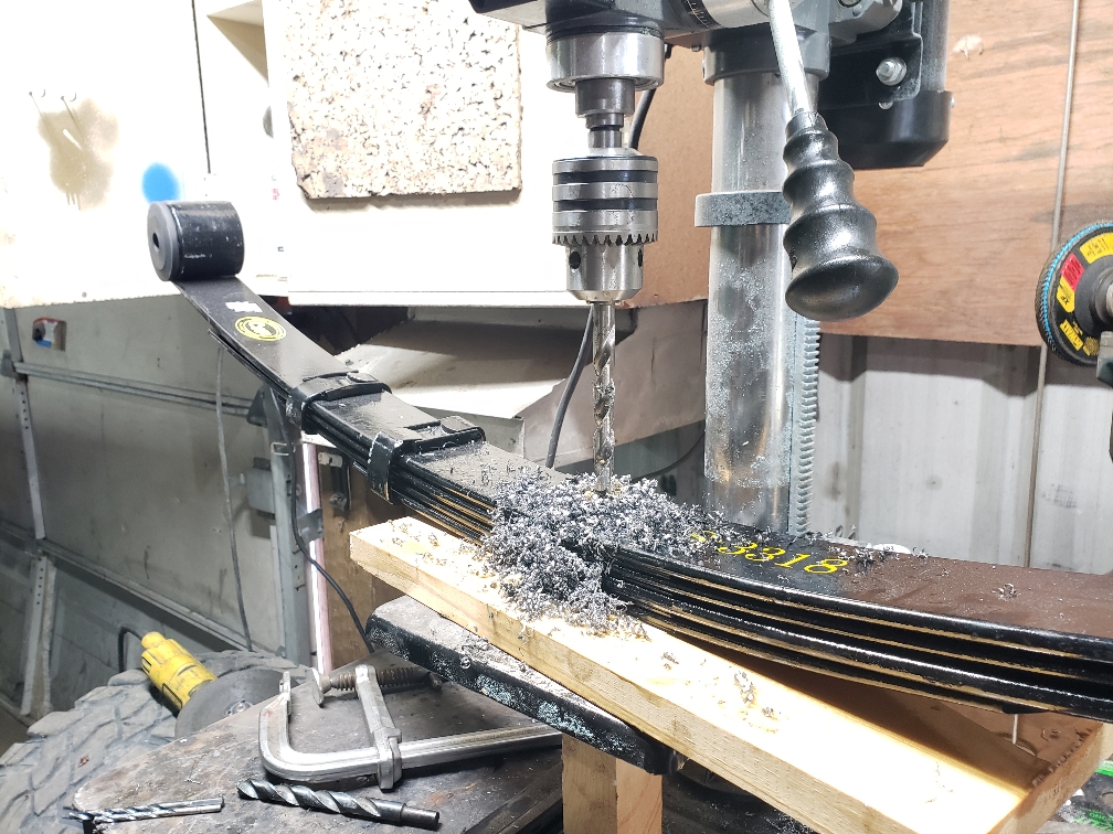

One drilled. Main reason for drilling is im running 5/8 center pins axle pads already drilled.
I drilled factor leafs with a hand drill. These crowns are much harder. 4 bit process working this harbor freight press pretty good.

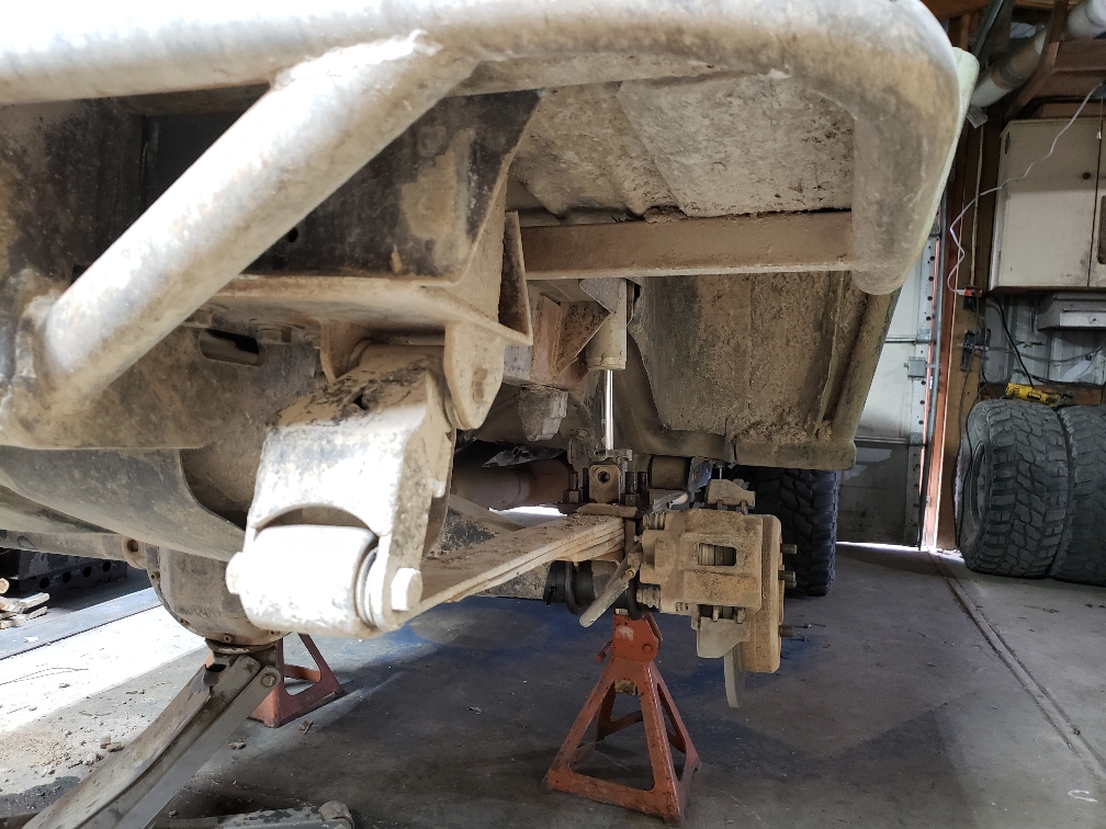

I only gained about 1" over my ragged out leafs. Im thinking about cutting the main leaf on the factory pack just barely short of the crown spring eyes. I think ill get another inch and should increase spring rate aswell as support the crown leaf. Pack should still settle to just alittle arch at ride height maybe alitt more than pictured.
Im hoping to gain a couple inches and be able to support all spare parts tools and passenger.
In the last 6months the factory leafs have sagged from 4.5" of shock shaft showing to barely 3 and bottoming out on everything.
I also have a short not quite zero rate 8" long leaf cut. But want to see what supporting the long main leaf does first.

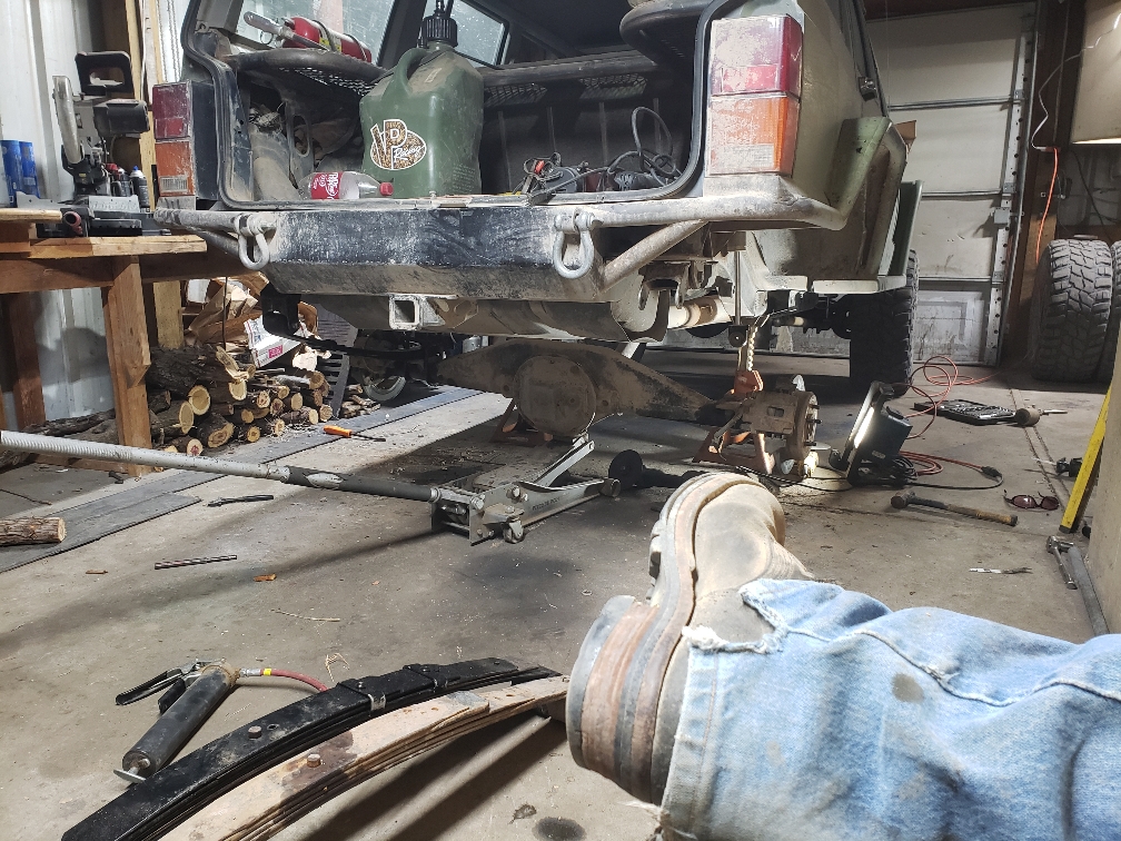

Ada leaf to the crown pack. Thats the factory main leaf cut down. Not sure itl do much.

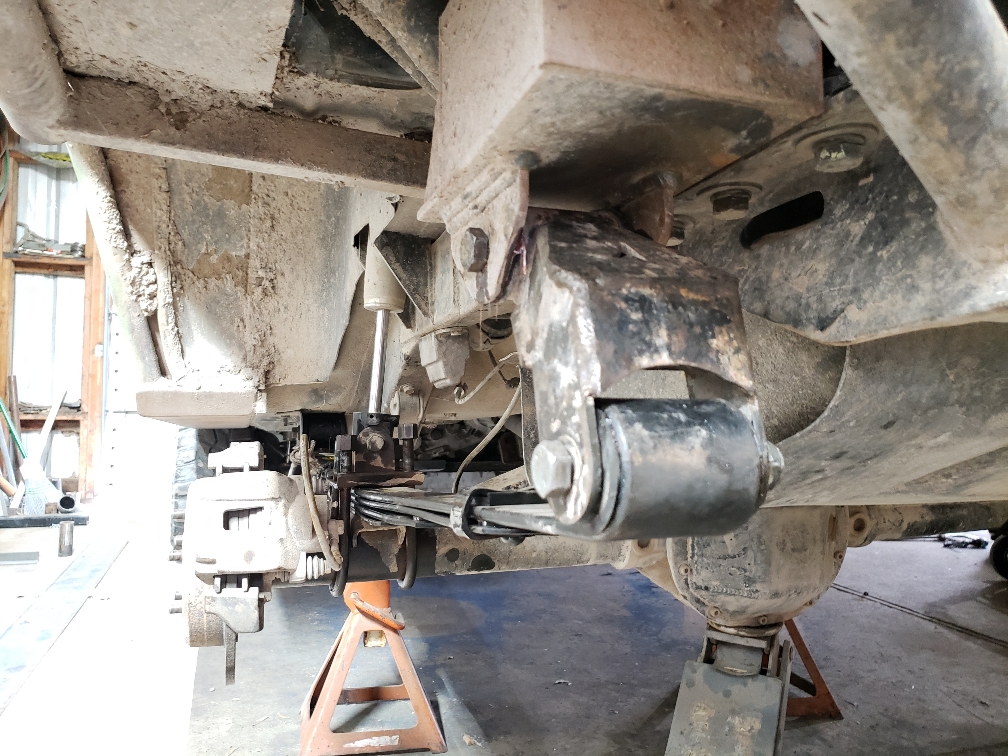

Just twisted the passenger side fron leaf bolt off. Working on cutting out the leaf spring and then tackle the repair. Might be building front leaf hanger boxes now
