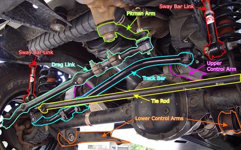

Gotta get your terminology straight here because this does not describe a particular part. I'm guessing you're referring to the tie rod ends (TRE's) because you mention a 1-ton upgrade.
Refer to this picture below to better describe what you're after. This image does not actually highlight and label the TRE's but there are four of them in total: One at each end of the drag link and one at each end of the tie rod (driver's side at end of tie rod is not shown in picture). I want to clarify that the name "tie rod end" refers to the ball and socket style joint and does not necessarily mean it is on the end of the tie rod (i.e. the two on the drag link)
