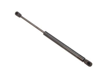

i'm just gonna strap a bunch of these together
if i want them stiffer, i will just add more. if i want them softer, i will take some out.
its the ultimate solution in go-fast suspension adjustability
Get the ones from a Range Rover, I hear they're the best in the desert...
