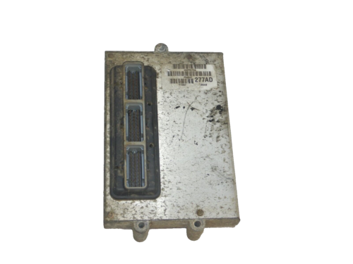

Hello, I am in Europe, my 1997 4.0 automatic Xj is equipped with an immobilizer with RKE box, I would like to find a new PCM not equipped with an immobilizer but I am afraid of coming across a PCM equipped with a SKIM.
Can anyone tell me which PCM I should buy?
I found one on e-bay but the seller doesn't know if it was on an XJ equipped with a SKIM key:
If any of you have a PCM for sale for 1997 XJ 4.0 automatic without immobilizer no SKIM and no RKE with remote control, I am interested.
THANKS
THANKS
skim, did not start on US xj's until 99 56041277 is for a 97 auto there is a good write up on removing the immobolizer on fb xj https://www.facebook.com/groups/139...p-ive-somehow-managed-to-po/2618947511627856/
