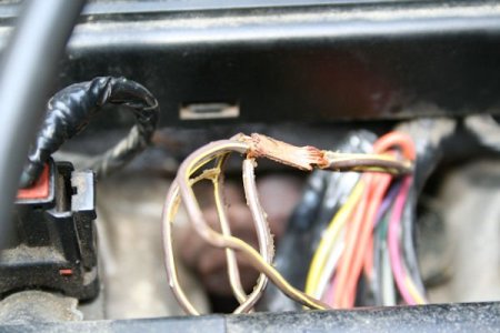

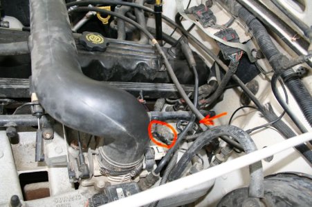

Suspect wire harness defects shorting out the 5 volts CCD Bus. Any of the OBD sensor wires could be the root cause. Don't forget to check the O2 sensors and wires.
Horn circuit shorting to the TPS circuit is a logical suspect. Failed wire splices and failed wire insulation are other good suspects.
