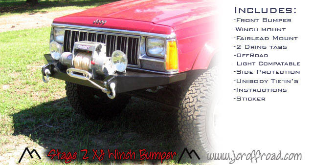

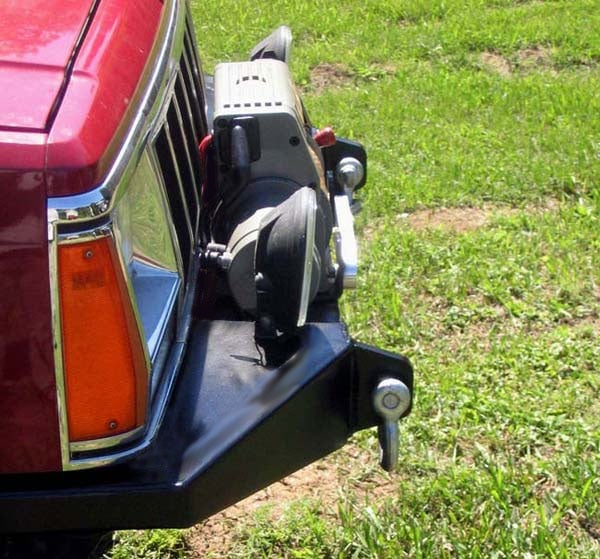

When was the last time you looked at their www?:sure: :twak: Side protection is standard now!! Basicly they F*#@ed up the bumper and did not get the angles correct which puts the side protection too far forward!!. Without the winch the bumper looks like it would make a good shovel...:D
This is what it should have looked like!!
Hey, on the up side, you have a lot more protection up front than you had with stock. Hell you could take out a tree with that, and not hurt the grille.
another thing you could do is use some of that realestate to put some pre runner bars... like JeepinCoastie has in his post. Just need someone with a welder and some low cost tubing. You could get creative and design your own. Get some fab shop to weld it up. shouldnt be too bad. ;)

Kinda fugly if ya ask me.
Thoughts? Opinions?

Negative sir, I know the owner of that Jeep personally, and the bumper posted above and this one look nothing alike, even without the stinger.
the reason i said it i said that was if u look on the bumper i posted it looks like the side protection doesn't go all that far back ....

The XJ on their site is pre 97 which also makes a difference.
That thing's gonna give problems just when parking! The number of times I've been glad my corners are more tucked than a winch bumper would suggest...

at least you will always have a place to sit down
haha, he can paint it yellow and it'll look like he's driving around with a school bench on the front of his rig. :)

My thought is we screwed something up... I dunno how it made it out like that, probably because it's harder to tell the difference on the floor than on a Jeep. I wish I had a chance to clear this up before this thread turned 3 pages long...
We did slightly change the design of the bumper (angles of the side pieces) since that first prototype. The angle of your picture is tricking my eye, so I can't tell how far yours is off from how we typically do it now... but it is off.
We changed the angle of the side pieces about 5 deg (and shortened it overall slightly) so we could us a shorter blank for the bumper when we start building it. Since we buy our 5x2 box tube is 20 foot sticks, any way we can save a few inches means we can get one more XJ bumper out of a stick as opposed to a short SWB bumper or the like. That means it saves us and you money in the long run.
The initial change did not hurt the aesthetics at all in our opinion. The total distance from the front of the bumper to the front of the grill has never changed from that initial design. It has always been the shortest possible without the winch hitting the grille.
At any rate yours looks wrong, and it's obviously our mistake. I will be in the office tomorrow if you want to give us a call. I will send a UPS pickup for that bumper, and we will have you a new out out ASAP. Sorry for the issues :eek:

Oh please!!Thats not just a simple change!Your actually using "more" material!

Hi... his bumper is wrong. The sides are not angled back enough. They are angled back far less than the prototype he is comparing it to, and much less than how we do it now. I would love to be able to show pictures, but I can't because I am at home.

If it were a 1/2"-1" Id probably agree,4"-6" is not a little less than before!You should change your website and inform the customers when ordering!

Sure,Im in! So the CNC plasma cutter just made a mistake(twice,one for the tubing and one for the filler piece),the welder didnt notice the difference,and nobody picked up on the "strange new bumper we build".
