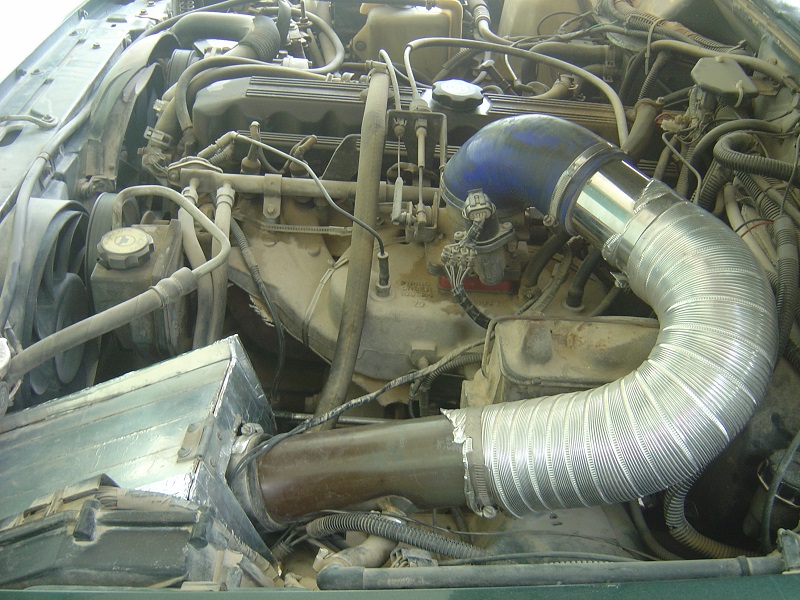

Everyone except me. Here's my current (crude but effective) set-up:
Hidden behind the heatshield is a 7" S&B Powerstack cone filter.
