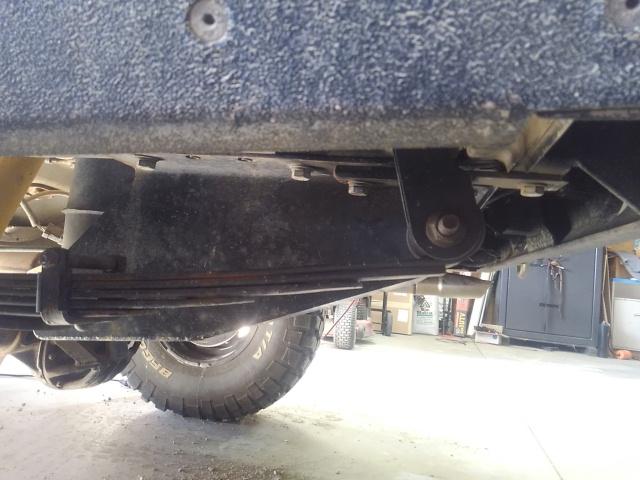

I just recently installed shackle drop brackets on my 3.5" OME. It appears the angle is better than stock but it's still not near "ideal" 45*. So now I'm about to install SRB from Rough Country (arrived today) to improve shackle angle. Possible downside is the added lift the from the SRB. My lift is 3.75" rear & 4.0" front, fully loaded. I'll post pictures before/after of the SRB. If the look and/or feel is wrong I might go with MetalCloak 4.5" progressive front springs and CAD (Control Arm Drop) brackets. Round and round.

Is it just me or does that leaf pack have twang like a 30year old pack. I see a slight S shape to the main leaf.
Probly isn't why the ride is rough just something I noticed

Yeah, I see that too. Probably going to end up with new springs all around before this is over. Have a run planned Sunday after Thanksgiving (weather permitting) so will see how it performs/feels then.
OME leaf packs have maybe 500 - 1000 miles max and very little offroad, nothing difficult. 3.5" springs measuring 3.75" with drop shackles and full load of a few hundred pounds.

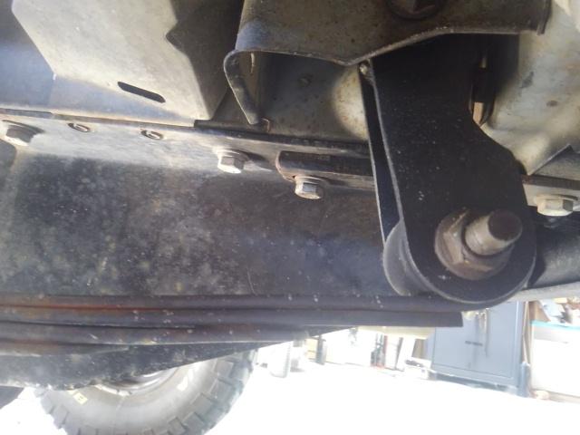

How's that shackle angle look?
Looks not great. Should be 45 degrees or so back, you’re not quite 90, maybe 70 or so.
