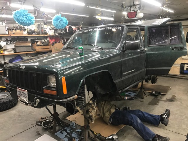

Before:
During:
After:

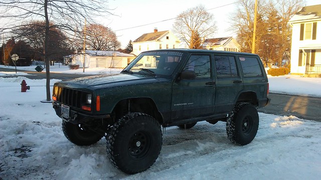

Not much visible change, but oh what a difference in drivability. Loving my 4:56 gears.
Big thanks to MacGyver and Grace for the garage time, beers and a place to sleep off beers. Hope I didn't leave too much of a mess.
Thanks also to Seth Barrand for setting up the gears and putting up with my drunk azz.
Drinks on me next time.
Did he get you the gear sets or you just pay him to set them up? I’d consider this just to save some time
I bought gear sets from http://rwkhaussupply.com/ and paid him to set em up. He works for the dana factory and knows his chit. He does the work at Magyvers. I have about 1k in the entire job and I know it was done right. Win Win in my opinion.
To be more specific, this is the set I ordered: http://rwkhaussupply.com/usa-standard-xj-gear-package-special.html It had everything needed, other than the gear for the transfer to make the speedo correct.

Im curious what your fuel mileage is like with those. I was getting 17mpg on the highway with 4.10s and 33 but have to keep it under 70MPH. Other than gears, our jeeps are pretty close.
