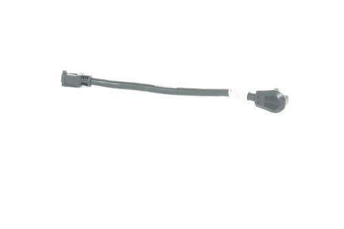

You camping people who want to run electric heat in your rigs need one of these
Found here,
http://www.etrailer.com/Wiring/Coleman-Cable/09544.html
or your local RV store.
Then plug one these in to that.
Then run separate extension cords to the people on your site to run their heaters. Only run three heaters, one per extension cord of the breaker will pop in the night.
