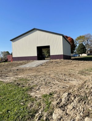

Once the pad was done it was time to build it. I hired a local Amish crew to get it done.
Interesting to note, I originally spec’d out a 40x60 with 14 foot walls. I later modified to 40x60 with 16 foot walls so I could have a 14 foot door, allowing me to park whatever I wanted in the building. I have a 31ft class C RV that was going in, expect to go back to a class A one day and after all, need to build to fit anything.
This was November 2021, lumber prices were all over the place. My build quote was estimated based on the the fluidity of the market at the time. My Amish builder was cool enough to lower prices if they went down from time of quote to being built. In the end the prices went down so the difference in 2 ft of wall height was barely noticeable.

The Amish built the barn faster than I could post photos. They were done in a couple days and the only reason it took that long was because it rained.
I did a 14x12 door, a 12x10 door on the front, and a 10x10 door on the back.
It would take 2 weeks to get the garage doors, which at the time during Covid wasn’t too bad.

The doors finally came in! I should also mention that I took some extra time with the contactor to find the right colors to make the buildings match each other.

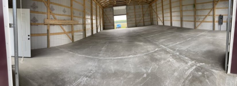

The next day, the Amish concrete guy had the trucks there and we poured the floor. I originally wanted to do heated floors. But there was a ton of work involved with setting that up and it was going to be super expensive. I have no regrets at his point about not doing heated floors. Before you ask, we did 5 inch deep concrete with some new fiberglass reinforced grating in it that makes is really strong? I dunno, we planned on a car lift, but hadn't 100% figured out where it was going, so we did the entire floor in 5 inch. Not sure what concrete runs now, but we paid $1 per sq foot per inch deep. 40x60 you can do the math. I'm told it was a good deal. The Amish concrete guy I used is the one that the Amish builder recommended and when the concrete guy asked who did the dirt work, he was pleased because he says the guy does great work.
The concrete was poured in June. They came and cut it a couple days later. I think we couldn't park on it for a few weeks. It turned out great.

I wanted to paint/seal/add texture to the floor. I didn’t want it slick and I didn’t want flecks in it. First up was letting the concrete cure, then cleaning, then etching.
Then I had to apply. I used a roller and applied the coating like paint. It had sand mixed in for texture.
Made it a family affair.
I did not get it done in one day.
Eventually, got it done and let it sit for a couple days.
