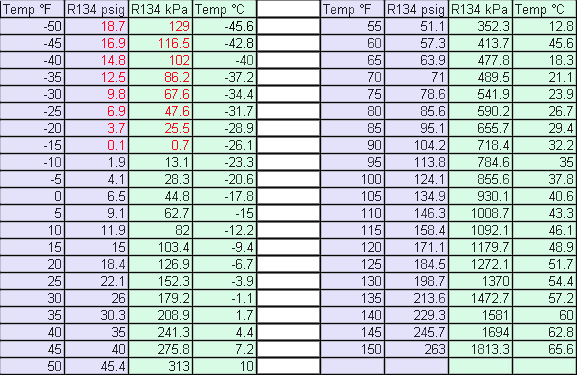

With the engine cold connect a refrigerant test manifold to the system service valves and compare the system pressure to the outside air temperature in front of the condenser coil using the PT chart below. The temperature and pressure should be within 2-3 psi of the given temperature.
Will those number still work if you have a system low on gas though? Also im failing to see what or how this chart tells me if I have r-12 or 134a. Just what a system pressure should be with OAT? Enlighten me please.
Except there's no practical way to discern a few psi difference on some fat needle on an analog gauge. And if he has a leak, the chart becomes useless.
