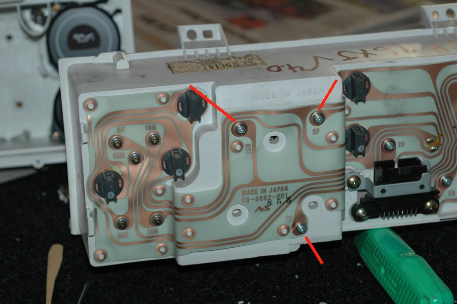

The speedometer is held in via 3 screws on the back of the cluster.
Those screws make the contact between the speedometer and the flexible printed circut so don't loose them.

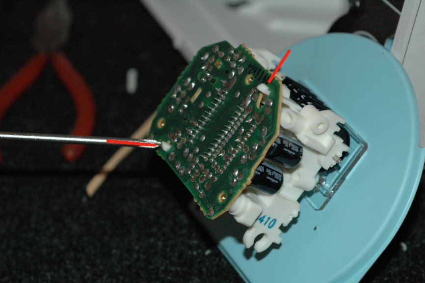

It should just lift away. There's a circut board under that held in by a couple of tabbed shafts. Gently pry the shafts back to clear the tabs and the board should come out.

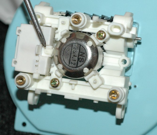

The odometer wheels are turned by a small gear unit that's held in with a couple of tabs and a small melted plastic button indicated by the screwdriver below. Use something sharp to trim the edges of the melted button so the gear drive unit can be removed. Bend back the tabs (carefully, they do break) and the gear drive unit should come out.

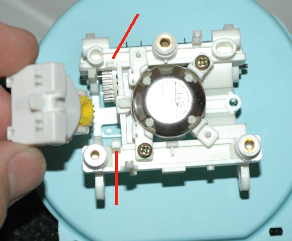

Tabs where the red lines are - the top one is broken (this is the old unit.)
