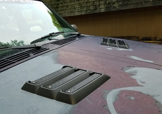

A very popular option that is generally affordable are lebaron hood vents.
I went with the Lebaron vents on mine. They helped, but I still heat soak if I shut down while running trails.
Hood vents, and an e-fan timer for cooling after shutdown. LeBaron and Pontiac Sunbird vents are somewhat common, ZJ 5.9 vents are less common.
My functional hood vents were donated by a Pontiac Sunbird.
Yeah but 5.9 vents are so much cooler. I don't seem to have heatsoak issues with my '00. I did have surface rust issues on the hood and roof. Figured since the hood had to be done anyway I did it just for the look. Can't post a picture of mine but you can see it here. Post # 84139
