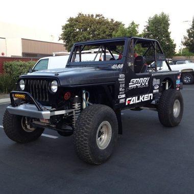

Disagree? Talk to these guys. They are kicking ass and taking names without coil overs.

if they werent in modified stock class i doubt they'd be running coils.....
I disagree. They are moving from stock to mod class and they are not switching to coil overs. They are adding bypasses, but sticking with the currie coils.
