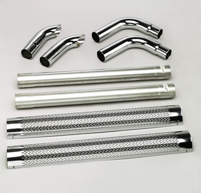

heres the kicker, can i run sidepipes and make it look good. it couldent be too bad, tid look kind of like rock rails

yes you could run side pipes and make it look good, but i dont think its worth the work. or are you taking run the exhaust out side the "frame" rail all the way back? theres no room for a muffler unless you run a glass pack

it would either look terrible or badass, im just not sure which. take the heat shields in and powdercoat them black.
good idea on the crossmember, thats probally what i'll do, and if i stick to the current plan, i'll run side exits in front of the rear tires.(ive got this aar-t/a fetish, i want to paint the hood black and put a t/a scoop on it, and aar side stripes) i know, im a douchebag.
