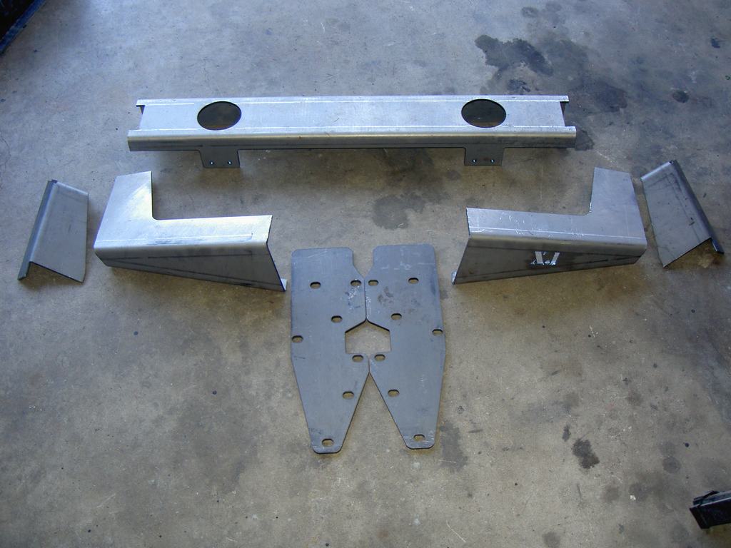

My home brew bumper...
The middle section with the tabs that go through is 1/4" (3x6) wall box tube, the angle on the ends are 5/16" (3x6)
When I get the funds together, I am going to chop the middle section out and install a real low winch cradle that does not block much of the rad. I am also thinking about adding some "cut outs" on the corners for a hi-lift lifting point that will "straddle" the jack making it less prone to slipping and killing me :gee:
yes I still need to chop the skirt out from underneath HAHA! I am going to wait till it's done snowing, to prolong the onset of RUST!

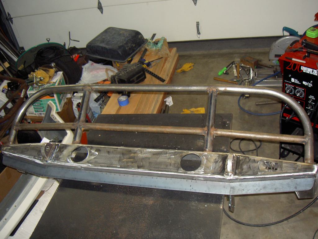

This one a friend of mine and I did 4 or so years ago. Its 2x6 square tube(forget thickness now). The D-ring mounts are 3/4" plate and go all the way back for the mounting points. Later we added a small tab to pick up the steering box bolts on the bottom. If this thing comes off it will have pieces of jeep attached to it :D.
Some crappy pics of the mounting, don't worry I have since resolved the crappy sway bar angles. Thats what happens when you forget to subract your sway bar drop brackets from your lift hiehgt when ordering discos :). Thankfully I traded with another member that needed longer ones.
