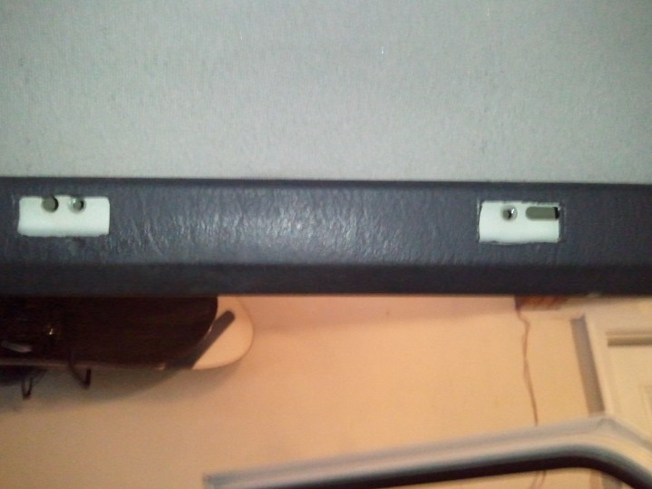

Not the most thrilling subject. Mods feel free to move to OEM tech. I installed a factory grab handle above the driver's seat. The holes were there, but I had to use the screws to create the threads.
To measure, remove the passenger side grab handle and use the distance from the back of the trim to the edge of the front and rear cutouts. Use the top of the trim to measure the height of the cutouts. Cut with a dremel. Be careful not to break the clips holding the trim on when you are pulling it away from the body. I broke the first a-pillar clip so I didn't attempt to remove the trim entirely. I just pulled it away from the body a bit and cut away. Took about 10 seconds per hole. Mess was minimal.
