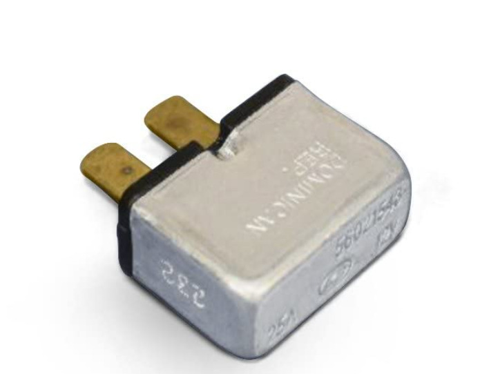

I checked continuity on the "circuit breaker" that silver fuse looking thing (56021543 25A) in the lower passenger kick panel and it had continuity (but not sure if this is a valid test given that its name implies some reset capability.
tonight it was very dark by the time I got around to testing and noticed that there was a very tiny flicker of light for about 1/4 second in the door control panel when I switched from 'off to on' so I'm wondering if there is some other relay involved or if the 'breaker circuit' is bad?
You can check the outputs at the switch for voltage!
There is only one wire that feeds cb#28 from the ign switch, so if it works in the accessory position and not in the run position it has to be the ign switch!
