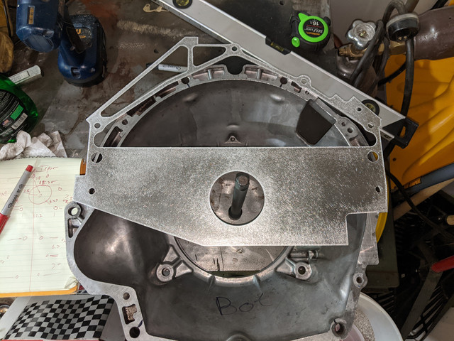

The transmission is the biggest issue. I'll leave a teaser pic right here. I think it's viable go keep the aw4. I also have a fall back plan to use the 4l60e. Time to sell my prerunner and start buying parts.
IT's fun and all to talk about engines, but what's your tranny situation? If going the LS route a new trans, transfer case, and driveshafts are needed. Assuming you now have an AW4, it wouldn't last long behind a boosted stroker unless you fully built it up.

I was planning to try and use a modified aw4 for either option. The 4l60e is a fallback plan. Lengthening shafts and such isn't a huge concern. It does add to the nickel and dime stuff though. The bigger concern is the added cost of a trans controller for the 4l60. I was thinking the aw4 would work without a controller for light duty work in case the wife drives it and just go to manual controls for my usage.
Can the AW4 even be adapted to an LS? I know Novak doesn’t offer products and seriously discourages it.

Can they? I think it can be done. I plan to try a bellhousing adapter with aw4 torque converter and spacers. Maybe the 4l60 bellhousing is a better choice and then I adapt it to the aw4 trans. Not sure yet.
Novak doesn't offer much in the way of explanation for the lack of aw4 adapters. From their site.
"The AW4 automatic is a stronger transmission, but its computer controls, funky shift points and overall quality when compared with the GM Hydramatics makes it a sub-par choice. The AX15 manual transmission, however, can be successfully retained in a GM engine conversion"
Sounds like it's more of a tuning or lack of tuning support issue rather than a strength or packaging issue. Full manual controls over and aw4 might negate much of the issues and allow me to keep my trans/ transfer case/ wirirng mostly stock.
