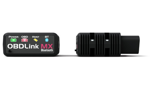

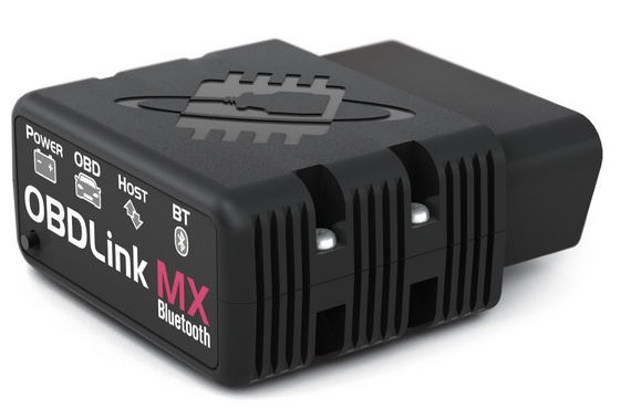

The OBDLink MX advertises no drain on battery if left plugged in, is that a problem with the other units, I haven't heard anyone mention it? I also like that the OBDLink MX can get firmware updates in the future.
