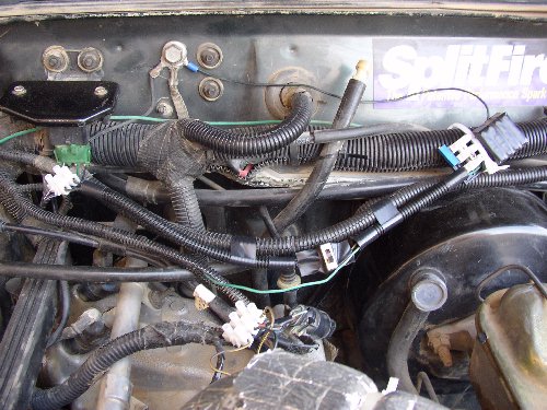

Since my engine's still running rich with the Ford 24lb injectors, I decided to add some adjustability for my air/fuel mixtures in the form of a MAP sensor voltage adjuster. Here's my article:
http://www.angelfire.com/my/fan/MAP_adjuster.html
This is how it looks now that it's finished:
Stock MAP input voltage is 5.0v. I have mine set at 4.6v and I'll keep adjusting it downwards until I've got the A/F mixture near stoichiometric. Hopefully my gas mileage (18-20mpg) will improve.

He he he, I don't have a cat nor an O2 sensor (standard Arabian Gulf spec) so that's not an issue. If I did, perhaps my engine wouldn't have been running rich and I wouldn't need the MAP adjuster.
