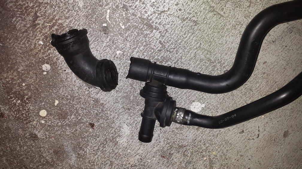

Been a while since I updated this. I had some issues last year that were a bit of a pain. I had some noticeable misfires that just sort of happened while driving down the road, barely made it to my destination. Wouldn't stay running after that. I tried to troubleshoot it but couldn't get it going enough to want to drive it home, so I had it towed. Insurance covered that so it did not cost me anything.

Did a boost leak test, no luck (passed). So I just started tearing it all apart. I knew it had to be in the vacuum system somewhere based on the first code which resulted in the rest. So I basically just started looking until I found something that was broken. Had to nearly take all of it apart before I found it.

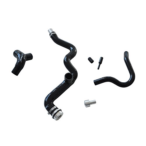

Here was the problem child. Not the shattered piece you see, that was in the process of removing all of the hoses. That elbow or whats left of it is the crank case breather. What failed is the three way valve it was connected to, the PCV. This assembly is under the intake manifold and not very easy to get to. I had to do quite a bit of disassembly to get to it, but much less than everyone said had to be done, carney hands came through again.
The crankcase elbow disintegrating is a very common issue over time. I did not want to have to deal with any of this again so I picked up a silicone breather kit from 034Motorsport with billet check valves. This eliminates the 3 way PCV valve. Got it all back together and it purred like a kitten. Ran better than it had in years. I used to have this little stumble at idle and I could never figure out what it was. My guess now is that it was the valve on its way on. In its defense it did that for years.

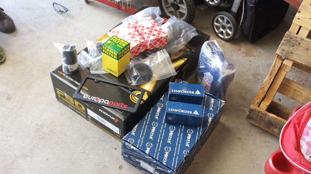

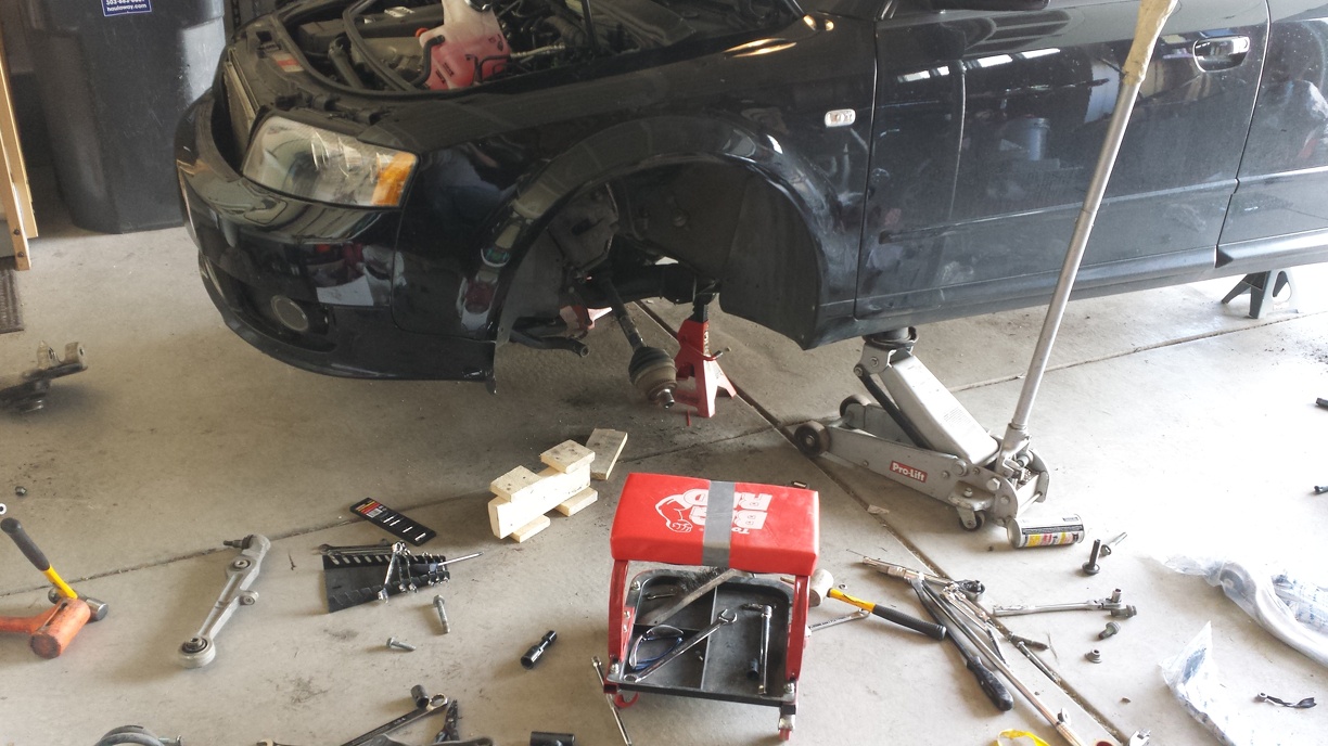

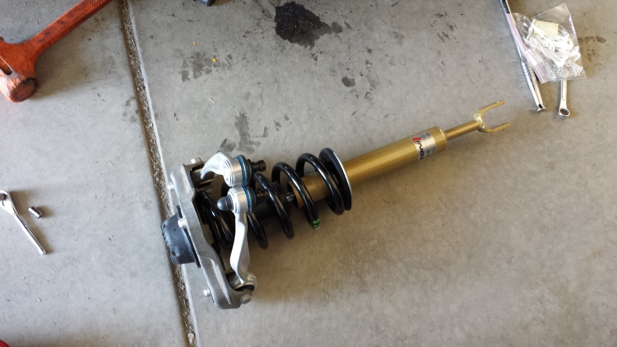

Been wrenching on it the last few weekends and this will be going into weekend three coming up. I was halted last weekend when I realized the outer tie rods were seized to the inners. Which did not end up being the larger issue, which was that the inners were toast. Also, the lower ball joints on the driver side did not want to come out. I ended up pulling the steering knuckle with both still attached and had to dead blow them out. This resulted in the sleeve coming out with one of them as it was seized due to corrosion. So I hit Napa for a joint separator that was just barely sufficient to pop the sleeve off. Used a ball joint press to push it back into the knuckle. Assembled everything back together on the driver's side, save the tie rod, and knocked the rear shocks out as well. Ordered inner tie rods and a 38mm crow's foot socket for this weekend. Got after it yesterday anticipating doing tie rods and the whole passenger front. Tie rods went fine, save for not having a pair of offset boot clamp pliers for the dust boot. The clamp on the steering rack end is almost inaccessible and can really only be tightened with this nifty tool. Upon tearing the passenger side apart saw that the wheel bearing was roached. So that's pretty much where I called it a day. Waiting on a new hub and wheel bearing, I'll have to get that pressed together somewhere. Next weekend, fingers crossed, it should be back on the road. At this point I still need to reassemble the passenger side, clamp the dust boots on both tie rods, swap the motor mounts, and do the oil change.
i.php
Full front control arms, outer tie rods, motor mounts, struts/shocks, and an oil change.
Got it all back together and out of the garage. Still needs an alignment, it's fighting itself pretty bad.

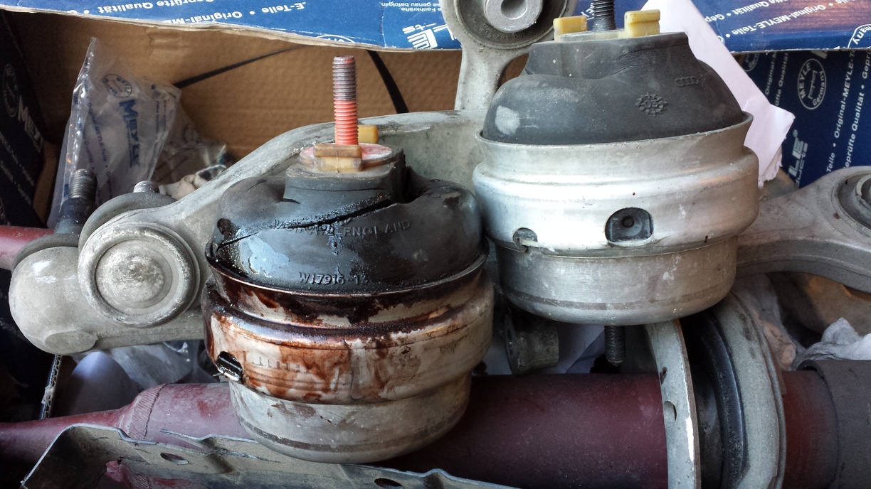

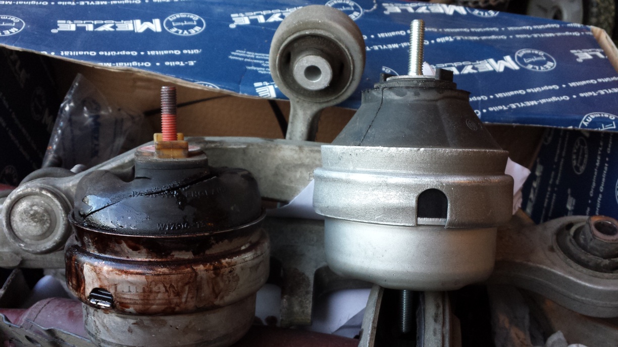

Both motor mounts, 83,000 miles on them. For those unaware, the Audi motors mounts are oil filled. You can see just how bad the passenger side was.
Replacement 034 Motorsport solid motor mount, no oil filled void. This is the normal shape and what the factory mounts would have looked like new.
