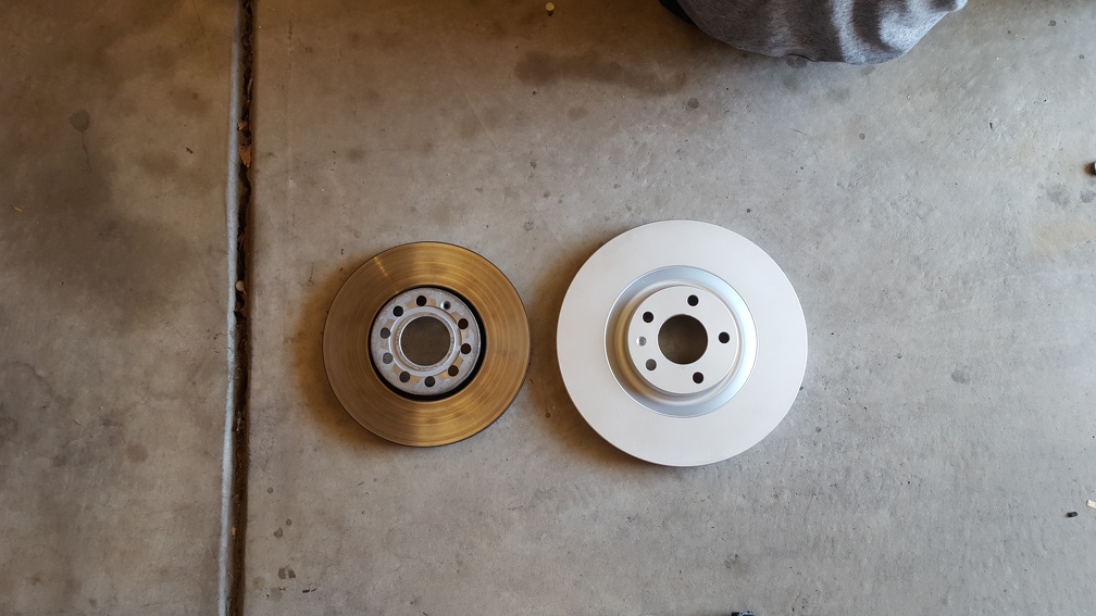

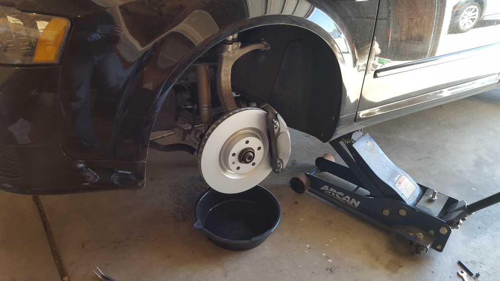

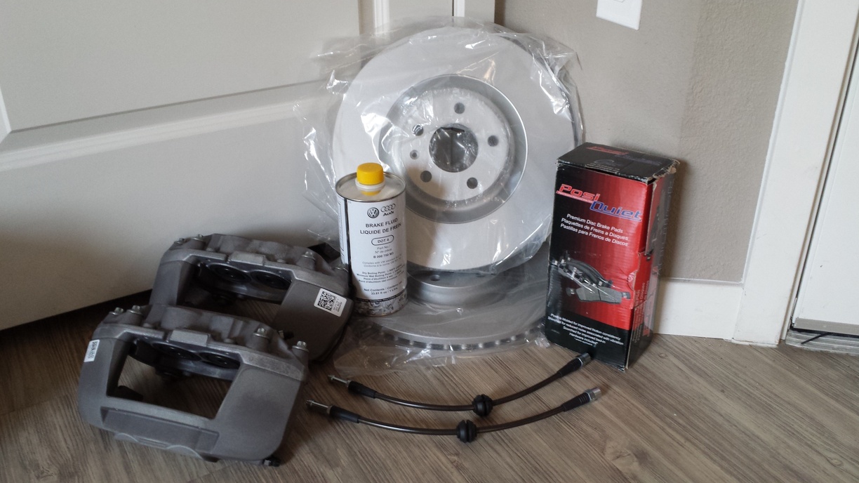

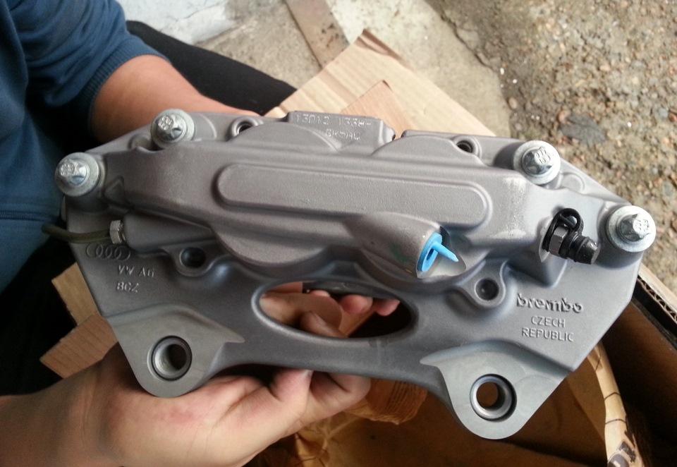

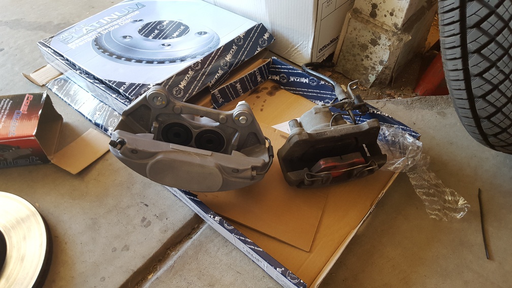

Installed these a few weeks back now. This is a factory Q5 Brembo 4 piston caliper with an S4 345mm rotor. Stock brakes were single piston, 288mm. The upgrade in stopping power is amazing. Before I used to feel like an emergency stop on the highway would lead to me sliding under a semi. Now if you stomp on it these things will put you through the windshield.
Gotta love Brembos. I can absolutely identify with your improved stopping power with those. Curious to see what the brake dust situation will be with that set up. The factory Brembo pads SUCK. Dirty, dirty, dirty.
The Hawk pads I put on the SRT8 have been amazingly clean and yes, there was a small notable loss of stopping quality at speed, but the in-traffic or at stop light slow speed sudden stop is gone. It's not a track car so we're very happy with the change to the Hawks.
That brake upgrade alone has to be one of the best things ever.
The EBC redstuff pads I had before were pretty dusty. I still have those on the rear so it will be a nice comparison over time. So far I am not seeing a whole lot with the Centrics. I definitely have a more noticeable cold bite than before beyond what I would expect from just the caliper change. Hawks were on my list and are typically well liked by the euro crowd.

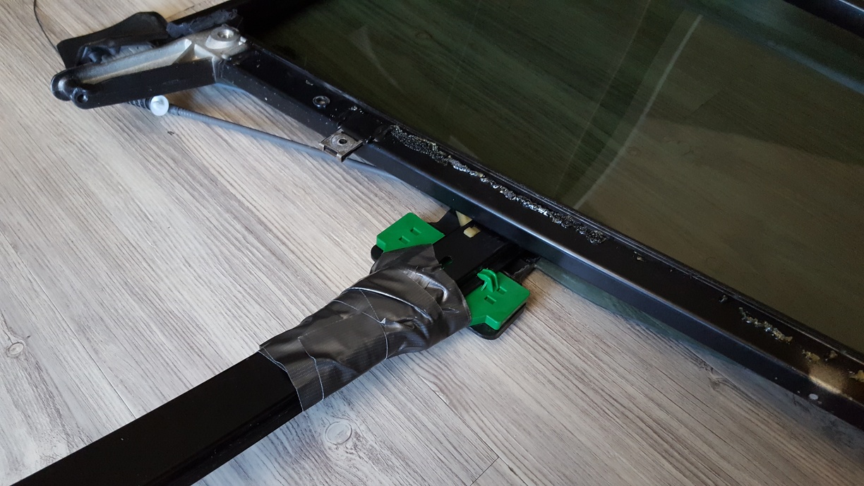

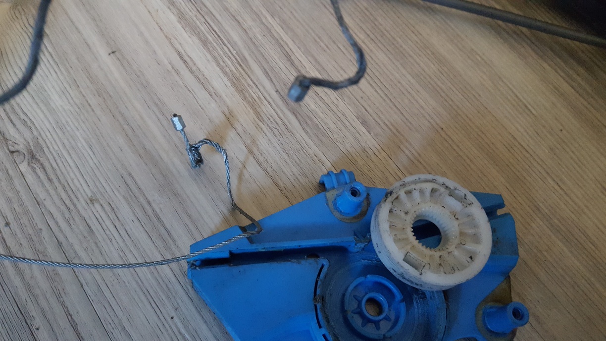

Passenger rear window regulator imploded last night. Annoyingly enough the plastic slide on this regulator broke about 4 months ago. The single part is not serviceable, but they break so often that a company started making them, $15 a pair IIRC. So I was just in that door not too long ago. The orange piece is factory and you can see the channel that holds the cable has broken apart. The green replacement actually broke while I was installing it, mostly my fault. So I ended up ordering another.
Fast forward to last night. The Audi regulator is $120 and lasted 12 years. Probably going to pickup the ÜRO replacement for $31 with a 2 year warranty. Likely the first non-oem/non-upgrade part I have put on this. But it's not like the window gets a lot of use and I probably won't have it for another 12 years.
