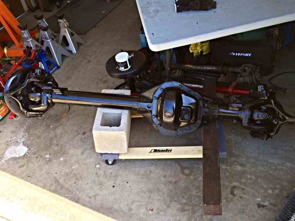

So I picked this axle up for a song. It's a driver side low pinion dana 70. 67 wms 3/4ton brakes. Full time hubs and gears 5.13 with a LSD. It's missing the driver side spindle, hub, disk, and caliper. What I can see of the bom is this:
604372-6 4 11 9 9b
It is massive but I couldn't pass it up. I'm going to try and see if it will work for me. I'm sure it's more than I will ever need on 37" but if I ever want to go bigger I'm sure it will accomodate nicely. I have a 14b planned for the rear. So...
My plan is to weld up the diff and swap in some manual hubs. I'll probably run the 5.13s if they are in good shape. If not I'll be bumping up to 5.38s or higher. We will see.
My fear is it's too large for the height I'm planning to run. I will not be running any more than 4" of lift. Preferably 3". I'll be linking it up with the ruff stuff three link kit. And running Hydro assist.
Any and all input and suddestions are welcome. If I figure out this will work I will be updating this thread with info and lots of pics for others to draw from. It will be slow though. I will not be installing this axle set until next off season.
