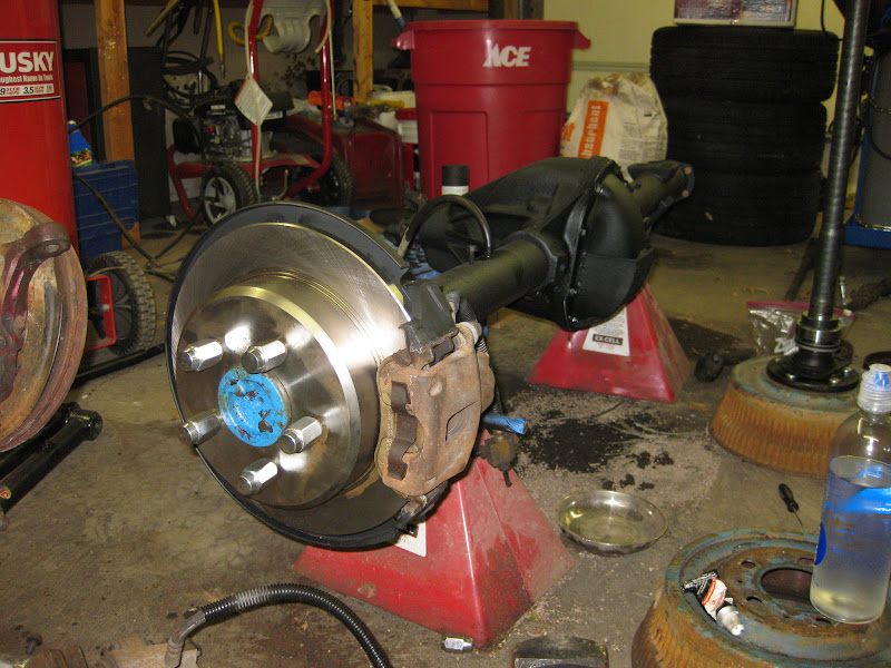

Your axle looks great, hidperf. Next time I have to tear into mine, I will be making it all pretty. Probably when I replace the discs with ZJ discs, get new pads for the new calipers and put a new shackles on the leaves.
I ended up using the old calipers, because the new ones I have, have a larger diameter hole in the caliper piston. I could have bent out the three prongs to get them to seat, but figured I would just use the JY calipers and pads to make sure I don't run into any problems before I stick shiny new parts on there just to get destroyed.
Thanks. I had the luxury of having mine on the shop floor working on it. It's much easier to "make it all pretty" that way. I wire wheeled the housing to remove the loose rust and paint and then coated it with spray-on bed liner. The diff cover, caliper brackets and dust shields were all sandblasted and painted with rustoleum. I haven't done the calipers yet. The rotors that came with the pile of parts weren't worth turning so I picked up a pair of ZJ disc for under 30.00.
