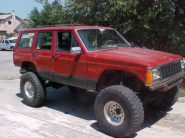

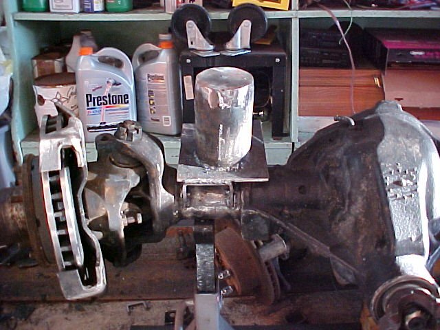

BTW, my rear is actually the waggy 20, not a 44. Here are a couple pix;
