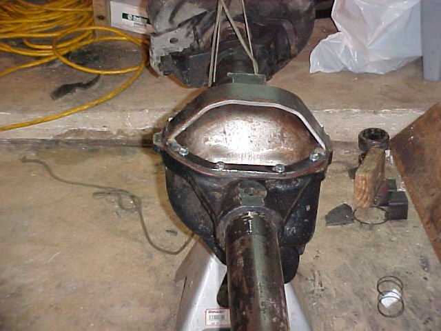

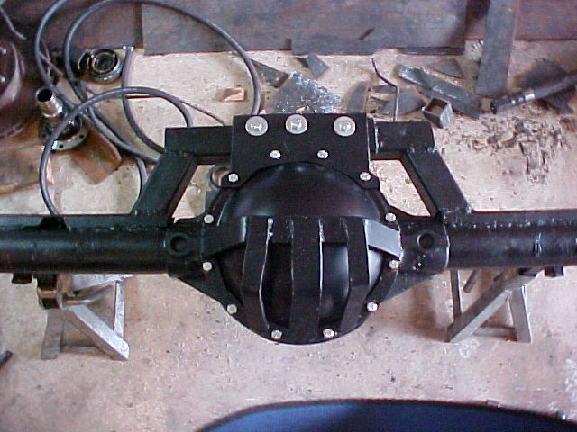

Here are mine, not pretty, but should work.
I'd pass on that one Kejtar, it'll bend on the first hard hit. This kind of stuff is simple to make and is why a welder will pay for itself very quickly. Even an inexpensive 110v gasless mig will do most of the projects that the beginning Jeeper will build. As you progress and have bigger projects and deeper pockets you can step up to a bigger welder and sell your old one (there's always a market for them). Come on, just do it!
JNJ, the second cover shows promise, run a weld along the strap and it will add a lot of strength to that cover.TC
4x4 doctor is what I had and I beat the heck out of it. The tubes offered more strength than flat strap. $64 well spent. My new 60 cover has 3/8"x3" strap welded on it over the ring gear
