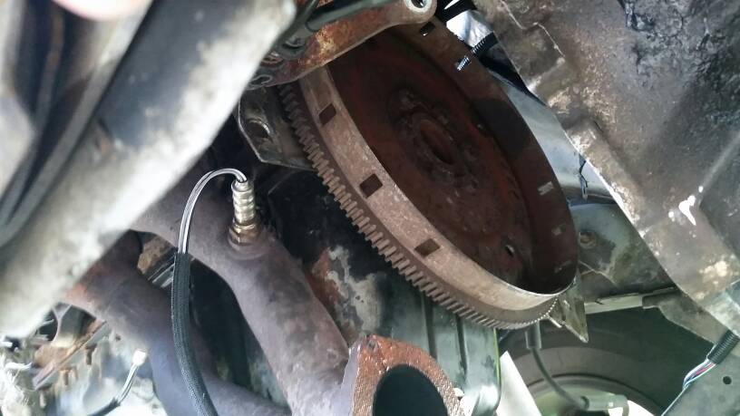

I bought this Jeep in Nov/2015, and never noticed this noise/vibration until after I installed my SYE this past March. Almost instantly, I noticed that while under load (1500-2500 rpms) and in every gear but OD, there was this really apparent tap/vibration from right beneath my feet. As soon as I let off the gas though or as soon as it kicks into the next higher gear the vibration subsides a little. Then, completely subsides once in OD.
My initial thought was incorrect driveline angles with the install of the SYE, but the rear pinion yoke is correctly aligned with the TC side yoke. Just a week ago, I happened to come across a thread about loose flexplate bolts and cracks.
So, I pulled the cover this last weekend. All bolts were tight and I didn't notice any cracks. I actually pulled the bolts out, and re-tightened with loctite to spec. I did notice though, the holes in the flexplate that the 4 bolts go through are somewhat 'ovaled'. I didn't know if this is how OEM flexplate comes, or if those 4 holes should be as tight as the o.d. of either one of the 4 bolts. There was a slight bit of play in the flexplate (fore and aft) if I pryed at the flexplate teeth with a wrench (maybe 5-10mm of play). Also, I let the Jeep run with the cover off and there's no visible wobble - it seems centered.

Well, I have some updates. I'm happy I now know for the most part what the issue is and why. Not happy that I only got 50% done this weekend and now have no way to get to work tmrw lol.
I got the tranny dropped, and in doing so found that the one E14 bolt was looser than just finger tight. The other, completely missing. Also, one of the 17mm bolts that threads through the alignment dowels was completely missing. So I'm fairly positive this is why the flexplate took a crap. It's got a pretty noticeable crack around the center.
