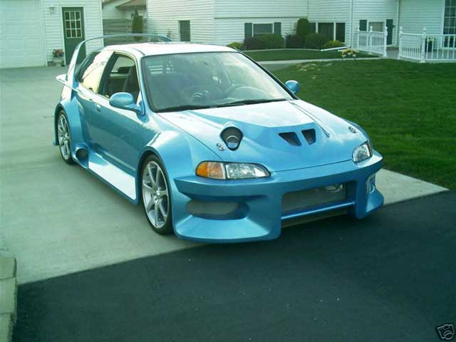

I dont think you could categorize this as rice....
THIS is rice...

HAY BBeach!!!!!
:roflmao: :roflmao: :roflmao: :worship:
Ya I thing that the 2nt one is........... Rice w/ all the Thanks Giving topings.:D
looks like fun.....YOURS?.................

Hell no, I dont think I can ever bring myself to buying anything japanese yet with a few exceptions. As for ricers =lastara
