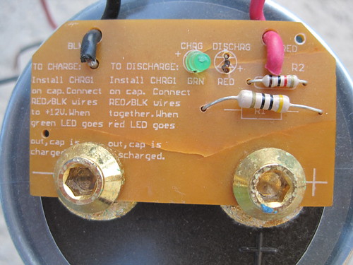

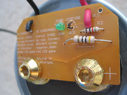

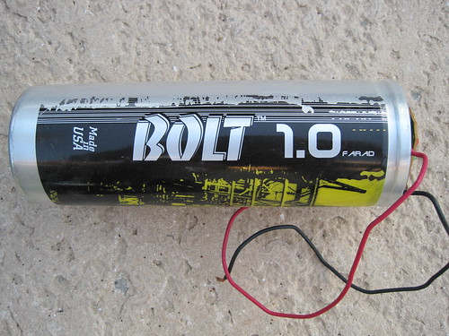

Any way to fix this capacitor?
suprbst
Yuba City, CA
Or is the burnt out LED even necessary? The circuit board is burnt, but I could probably put something together with Radio Shack parts if it's necesary to make this cap work. Otherwise, this will help when I build my single rear-pocket sub enclosure.
Thanks for the help!
that is just the charge/discharge unit, you only really need to use it the first time the cap is charged then take it off and put it away. its there to make sure the capacitor gets a full charge before the first time you install it, and to make sure its completely discharged (for saftey) before you put it away if you arent using it.
just chuck the circuit board and hook it up man, it should be fine.
