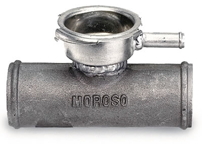

In my 1st 87 XJ, I spliced one of these
into the upper radiator hose, bypassed the whole coolant valve mess and mounted a generic overflow container in the same area I removed the "football" from. I think it cost me less than $80 total and it greatly reduced my cooling system hassles in about an hour.
