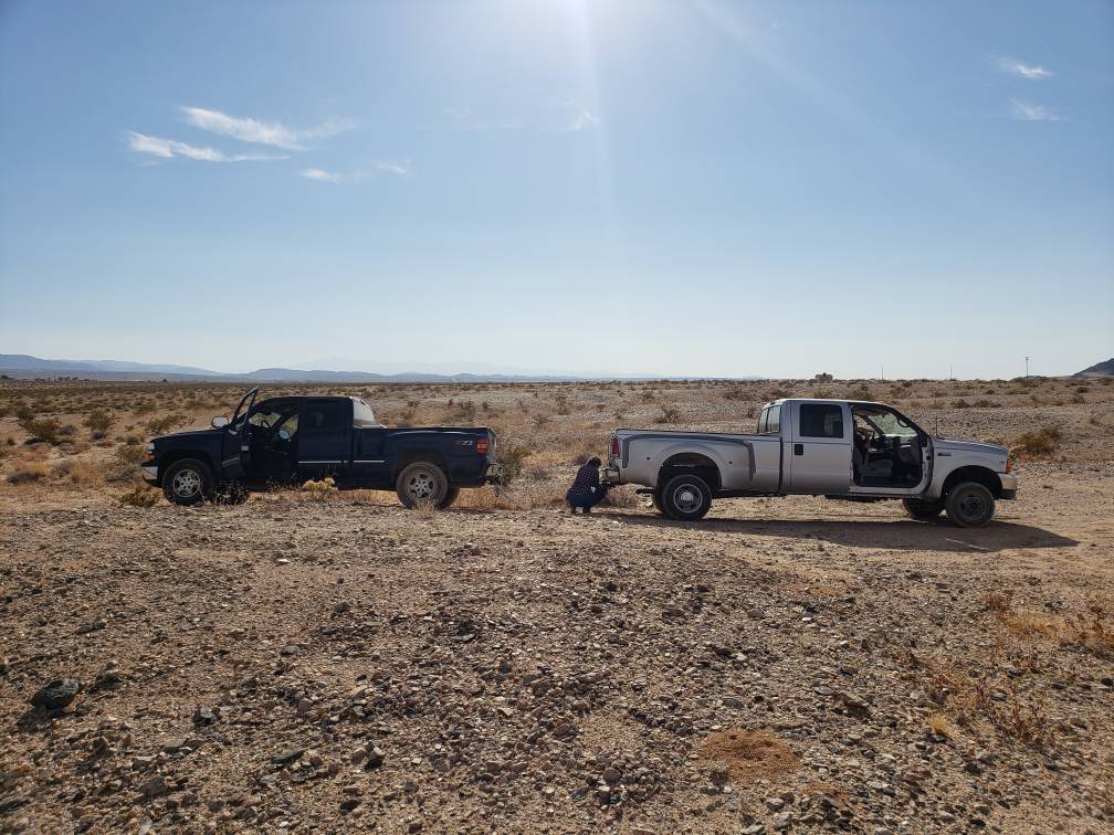

Got my Silverado stuck today and the $200 Doorless Dually was able to rescue it. Snapped my strap then hooked up the chain and it pulled it right up out of its holes and up the hill.
