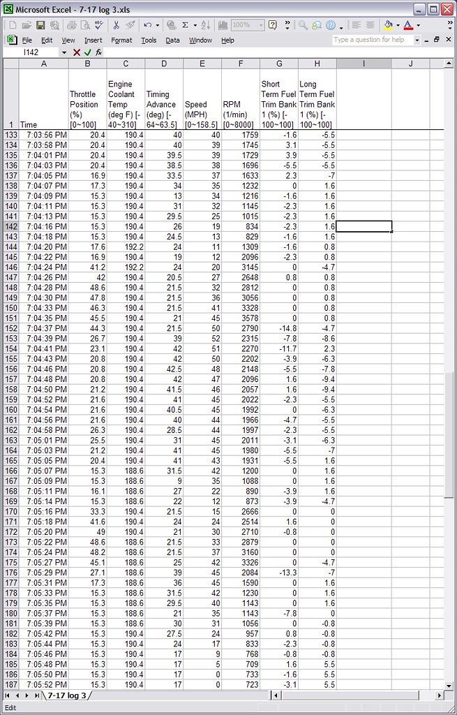

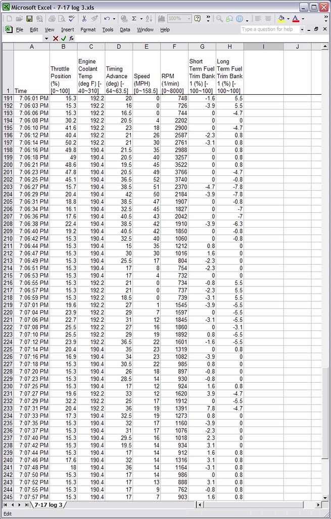

installed a set of 703's from two Neons this weekend.
A couple of screen shots of obdcom output. The first one is to capture the steady state behavior of the fuel trim during a period of 40-50mph. The second has a short acceleration segment.

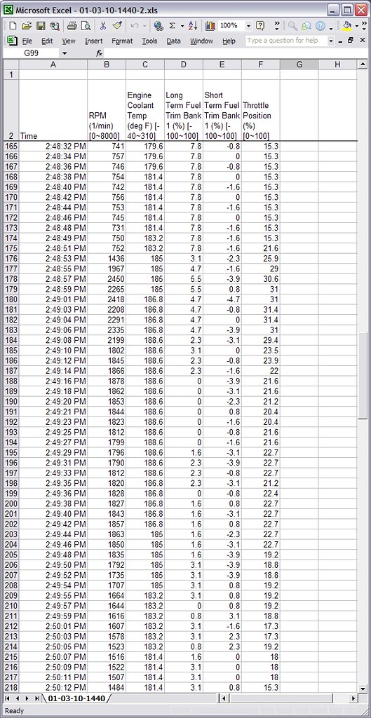

for comparison added a screen print with data on fuel trim on the original injectors, just steady state driving.

original(stock) injector data
It looks like over time it was learning from the short and long term trims.

1996 XJ. second page original(stock) injector data
I think the main thing I take away from it is that the trim numbers are not running at -10 or -12 as predicted earlier in this thread. My interpretation is that the computer is able to control the mixture without shutting down the injectors (shortening the pulse width?) too much. It's definitely pulling more fuel out than with the stock injectors.
There are a few places where a -13, -14 or -11 show up in the ST trim but those were when I let off the gas so presumably the computer needs to shut down the injector in a very short time to compensate for the lack of incoming air.
If the computer can control the injectors, maintain an acceptable mixture as far as the O2 sensors are concerned and not throw a code (because it isn't wandering outside the acceptable range) then not sure why this isn't an idea with at least neutral impact. Whether it's a good one (better mileage for me) remains to be proven.
As far as WOT (or opening the throttle enough to put it in open loop mode?) I almost never drive it there anyway so if the default is too rich not sure I care that much. Looking at the LT trim during those periods of open loop (when ST is 0) it's only -.8 anyway. Even on cold startup open loop the LT trim is +3.9 (which could be a lot, can't tell without an AFR gauge.)
On cold startup it takes between 1 and 2 minutes to go into closed loop mode so it's not squirting fuel that long.
In general the performance seems smoother but can't really discern a great difference. I'm hoping the improvement really shows up at the gas pump.
