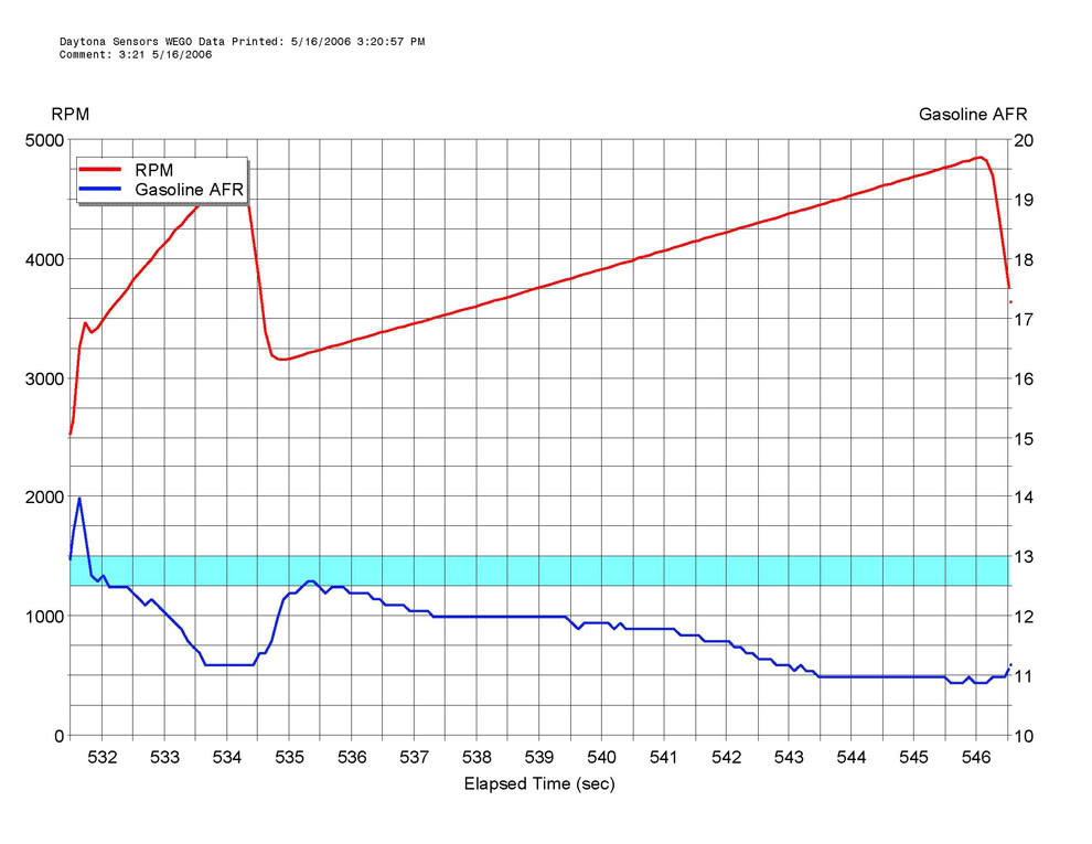

I tried to find the log I had of the first time I ran the wideband on my XJ w/4.0L, header, 0630 head and cai. Unfortunate I couldn't nor the image from that log, but I did find a post I had that said it dropped to 10.8:1 in WOT. Just to illustrate my point of it being rich at WOT.
Edit: Found it stashed at photobook. God that was a long time ago.
