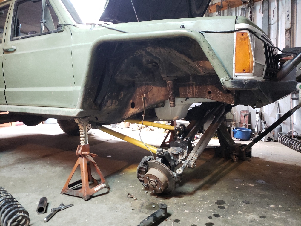

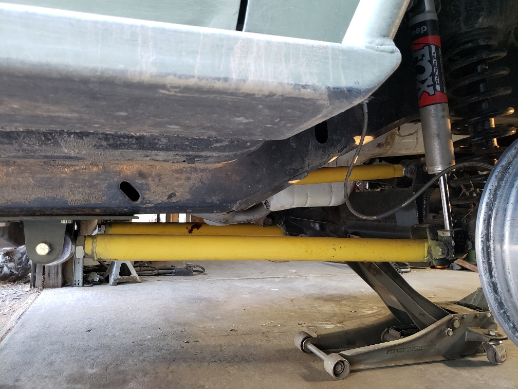

Hello, I am new to this forum and have a question about adjustable control arms.
I originally installed my LCAs with the jam nut on the frame side. However, I recently took my '99 XJ into a reputable local off road shop and they said I had them backwards and the jam nut side should be low at the axle. He said I'd only notice a difference when off road possibly and not on pavement. Something about the mounting brackets and the different style ends of the LCAs.
Most that I have seen seems to have the jam nut on the high side, although I have seen it both ways.
What do you know about this?
The photo is of a mechanic on YT installing them on the axle side, but I have seen other mechanics reversing them.

If the arms are straight it really doesn't matter, if the arms have any shape then that's built in for bracket clearance and generally the shorter end goes to the axle. Joint types (poly/rubber/flex-joint) do not make any difference.
Im running poly on the axle side because feel it doesn't flex theres. Heims on frame side because these joints need to follow the axle side.
Upper is heims both ends. Mostly so I can adjust castor by turning bar. Don't have to take anything apart.

I actually had already installed it with the heim joints on the upside. So he commented that they were reversed when I had it in there for something else.
