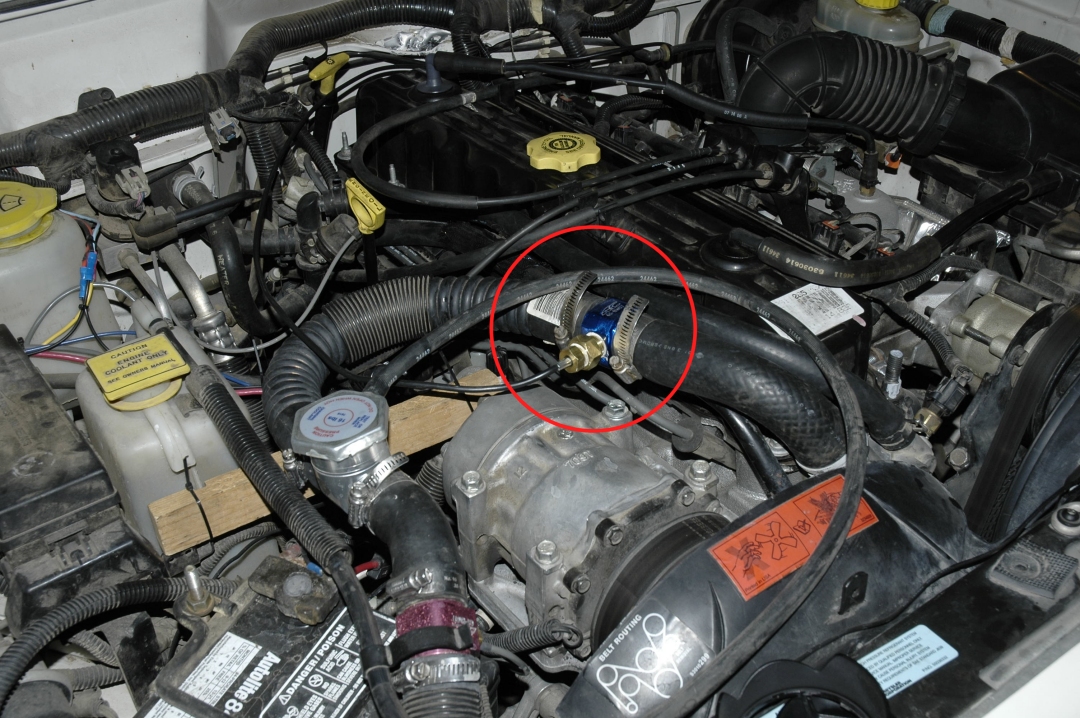

I did the in-line hose adapter thing twice in my 96, once for a fan controller and once for a mechanical temp gauge adapter. Since the pic was taken I've removed the in-line water filler neck; multiple radiator caps failed to seal correctly and draw water back in from the overflow bottle. And yea, that's a piece of wood holding the hose up, works fine.
Sorry for the pic size but it's easier to see what's going on:
I used the 1 3/16" diameter one from here.
http://www.jazzproparts.com/AC_Autotechnic_Accessories_s/1335.htm
I had to drill out & tap the one for the mechanical gauge probe.
I am using 2 separate relays for power to the 2 fans and letting the fan controller run those so not much power goes through the controller. Using a Hayden controller now but started with a Procool one and Procool fan. The Procool controller started to stutter a lot before it would turn the fan on and the fan never pulled as much air as was advertised. The Hayden (from partsamerica) comes with a 1/8 mpt probe and fits in the in-line adapter. I'm using a ford product fan(bought from someone so don't know for sure what it came off of) which will stick small animals to the grill and the stock electric one.

That is excellent, thank you. I've hit a wall a couple of times now, not knowing where to look for some of the odd pieces, but that should be just about perfect, once I get a sender (still not entirely sure what I can use in that regard, as Flexalite hasn't responded to my email yet).
At this point, I'm still pretty happy with the electric setup. Hindsight being what it is, I'd have done a few things differently, but I think it's better than what I had before, and a good radiator, along with a better probe and fan mounting setup, should wrap the cooling system up nicely.
Is that the mechanical sender in the blue adapter, and the electric in the red? Your junk is clean under the hood- aside from the block of wood, I'm jealous. :)

That adapter is looking good at this point, as I wouldn't have to modify anything but a hose, and I can keep my wiring clear of the belt.
