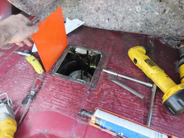

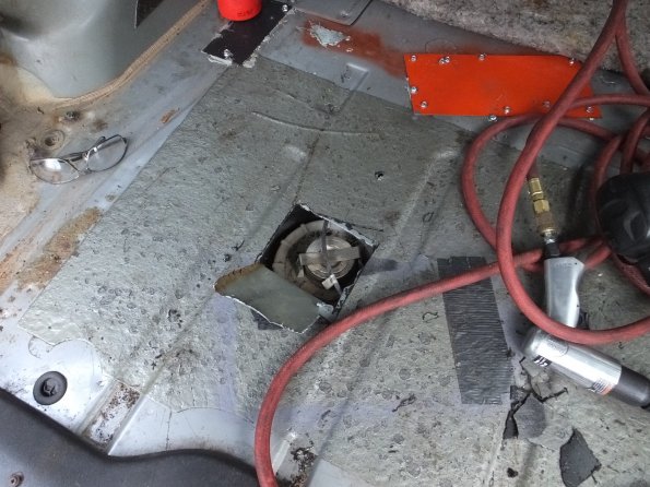

I used an air chisel with a forked bit to change the pressure regulator, but the pump would be the same except with a larger hole.. The fork limited the cutting depth and kept me from damaging the tank. I then secured a cover panel with very short self-tapping screws.
i.php
This is from a different jeep, for this one the tank was dropped first - much easier.
Nice.
I like what he suggests with a hole saw, assuming you can keep it from meeting the tank.
I don't particularly care for the wood spacer though. Wood expands and contracts with changes in moisture. A better option, as has already been suggested, is to cut a patch panel out of a junkyard donor.
I would also suggest sealing with butyl tape. CR Laurence RM140 Sunroof Butyl Tape works well. There are probably other, similar products that will do the job just fine too. Butyl is nice because it provides a good, weather and chemical resistant seal, but doesn't harden up and become impossible to service.

I always tell myself that I am going to just cut out a big section of the cargo pan in that area in a Jeep in the boneyard someday. If and when I ever do my pump I am going to drop the tank but still cut a hatch. Figure with a bigger section of floor will just be able to cover what I open without having to use the wood like he did. In a perfect world if I did the pump I would not have to ever go back in there and not need the hatch but......
