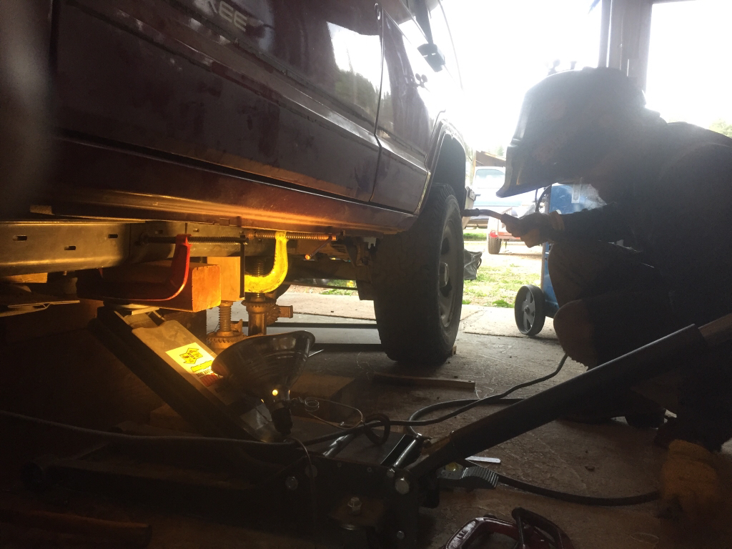

Got frame rails mostly welded on. I still need to remove carpet and weld up into floor pans. One or two other spots also need attention.
Driver side ready for ball joint removal. Passenger side needs to be taken down to axle.
Then it's time to start installing the new stuff!
