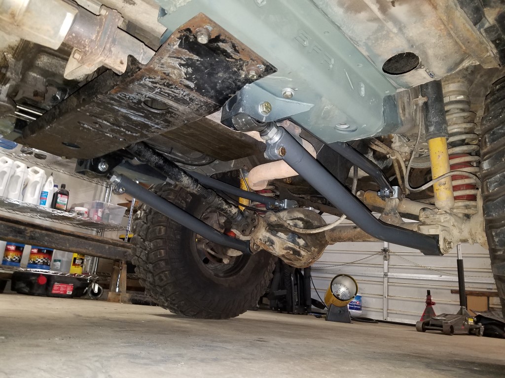

I can only comment on the IRO 3 link, as that is what I run on my 99. I have bought some stuff from StinkyFab, and are a fan of their products, too.
I do like the IRO 3 link kit very much. It fits and performs really well. Very well built. I also used it in conjunction with their Dana 30 over the axle truss. With that truss, it does have some challenges when setting caster. I found that you must remove the upper control arm in order to adjust it. I can't get it to turn fully when in the vehicle by just disconnecting the front joint, the arm has a bend in it, so it wouldn't turn. And you can't just drop the frame side joint, that joint fits into a pocket and has to be moved forward a bit in order to remove it. So you have to unbolt the front joint in order to remove the frame side joint. I also clearanced the upper control arm bracket on the frame side in order to remove it without dropping the bracket. It didn't seem like to me that you could remove it with the bracket in place. It just took a little bit of grinding. Hope that makes sense. If you had a lift, maybe you could drop the axle enough to be able to spin the upper arm for adjustment. I'm doing it on the ground of my garage, and I needed to remove the whole upper arm for adjustment
I didn't use their skid plate that's available with the kit. I run a 241 TC on this jeep, so I opted to use a skid plate from Rusty's, and just modify it to fit. I've used that same skid on my 97, with a 241. Fairly easy mod. I'm sure the IRO one is great, but that's only for a 231. Not sure what you're running.
Anyway, it's a great kit, but it does have some challenges. Not sure if those challenges were specific to my set up, but that's what I encountered. Hope that helps.

I don't know if it would droop enough, maybe. It looks like that's a by product of all the lift kits you are looking at. I don't know if having that IRO truss made it a bit harder, it was definitely harder to get the axle side bolt out. It wasn't that big of a deal, just kind of a pain, but once it's done, like you said, won't have to do it again.
Part of the issue with setting the caster, is having a reliable spot to put my digital angle finder on. I just couldn't get a good reading, and I couldn't trust the alignment shop knuckleheads to be able to set the caster for me. My e-locker wire and axle vent tube runs along that upper arm. I can't really blame them, no one wants to work on that without charging a fortune, and they have lots easier work to make money on. What I ended up doing, is trying to set the caster myself, and then taking it to the alignment shop and have them check it. Their equipment is much more accurate than mine. It took me 2 trys and 2 trips to dial it in, but it's all good now, and everything is installed the way I want it.
Looks like you'd have the same issue with StinkyFab or Barnes. I looked at both kits online, and while they seemed good, I don't see much of an advantage over the IRO overall. the IRO kit fit well over my frame stiffeners, too. I don't think you can go wrong with any kit, but the IRO is definitely good.
